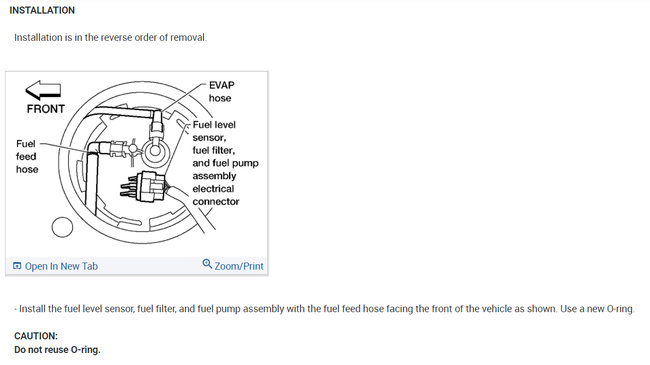

Hi, I have this problem for a month now. when i take my foot of the gas in gear except for fifth and sixth gear the car jerks back and forth and the rpm bounces. The car is a manual and no check engine light is on.
Jan 24, 2017 at 4:39 AM
STEVE W.
  • 15,410 POSTS

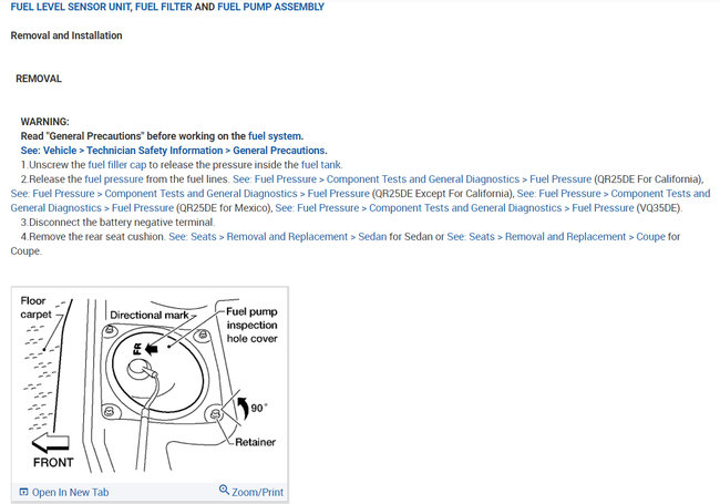

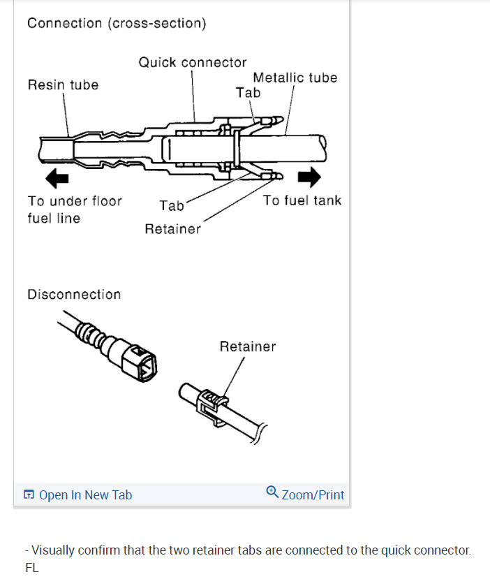

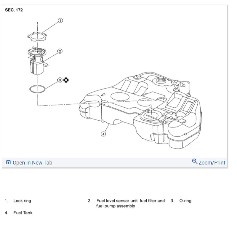

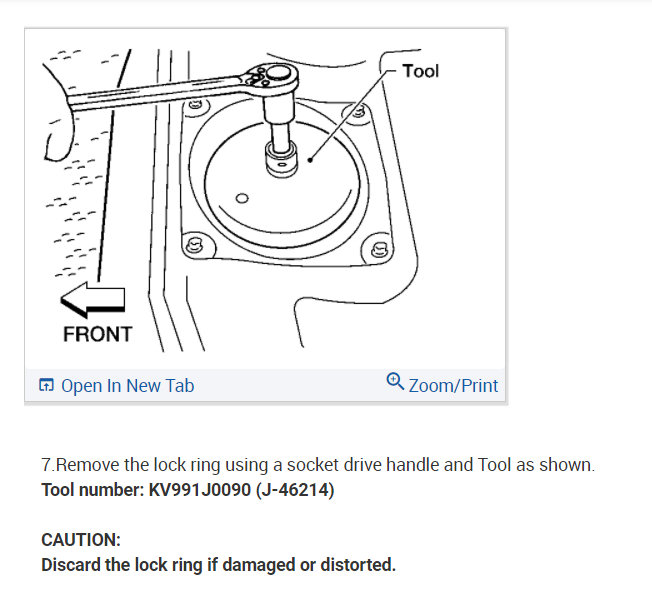

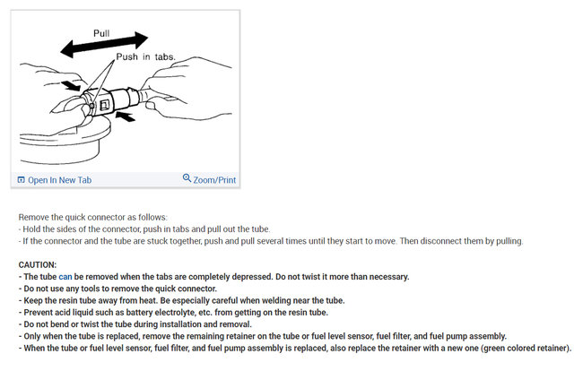

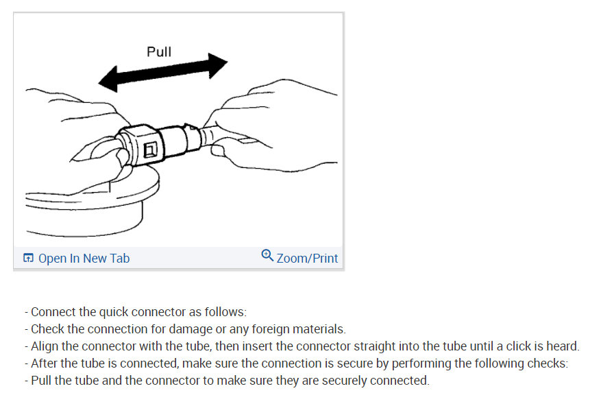

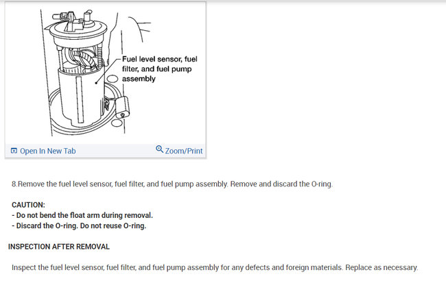

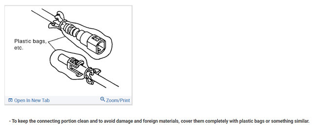

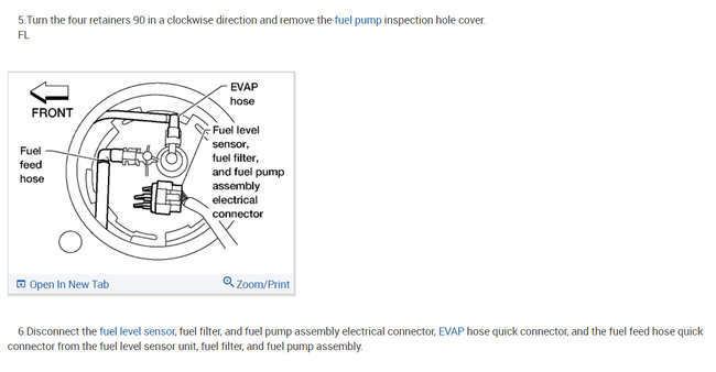

Here is a guide to help you step by step with instructions in the diagrams below to show you how on your car. For your car the fuel pump can be accessed through a tap door so you don't need to drop the tank :)
https://www.2carpros.com/articles/how-to-replace-an-electric-fuel-pump
This video shows the job being done on a similar car but the process is the same.
https://youtu.be/h_VHxBmecj8
Check out the diagrams (Below). Let us know what happens and please upload pictures or videos of the problem.
Jan 25, 2017 at 9:15 AM
HANASA HANASA
Hey steve thank you for your replay. I finally found a new pump and it fixed the problem thank you.
