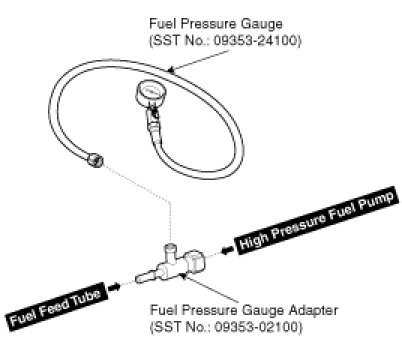

Two days ago my car started having problems starting. Then last night it started jerking when I was driving it. Before that, it started using lots more gas than normal. what should I do?

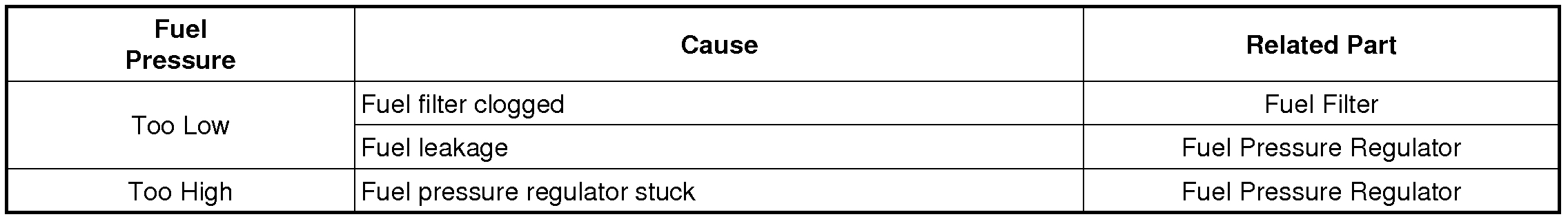

Since it started using a lot more gas, I question if the fuel pressure regulator is bad and allowing too much pressure to reach the fuel injectors.

Here are the directions specific to your vehicle for testing the fuel pressure. The attached pictures correlate with the directions. The directions also include general diagnostics based on findings.

2. Install the Special Service Tool (SST).
(1)Disconnect the fuel feed tube from the high pressure fuel pump.
CAUTION:
There may be some residual pressure even after "Release Residual Pressure in Fuel Line" work, so cover the hose connection with a shop towel to prevent residual fuel from spilling out before disconnecting any fuel connection.
(2)Install the special service tool for measuring the fuel pressure in between the fuel feed tube and the high pressure fuel pump .
pic 1
3. Inspect fuel leakage on connections among the fuel feed tube, the high pressure fuel pump, and the SST components with IG ON.
4. Measure Fuel Pressure.
(1)Start the engine and measure the fuel pressure at idle.
Fuel Pressure:445 - 455 kPa (4.5 - 4.6 kgf/cm2, 64.5 - 66.0 psi)
NOTE:
If the fuel pressure differs from the standard value, repair or replace the related part .

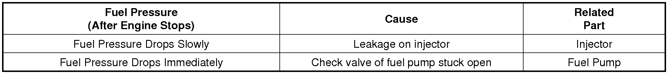

(2)Stop the engine, and then check for the change in the fuel pressure gauge reading.
Standard Value:The gauge reading should hold for about 5 minutes after the engine stops
NOTE:
If the gauge reading should not be held, repair or replace the related part .
