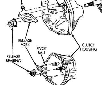

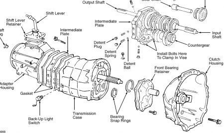

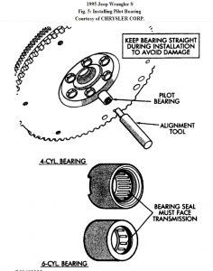

I have a chirping noise from the transmission when I slow down. It only happens when it's in gear and the clutch is released. If I slow down with the clutch depressed or out of gear there is no noise.
Sep 3, 2010 at 6:55 AM
MERLIN2021
  • 17,250 POSTS
Probably a release bearing or pilot bearing, need to remove the clutch to inspect them.
