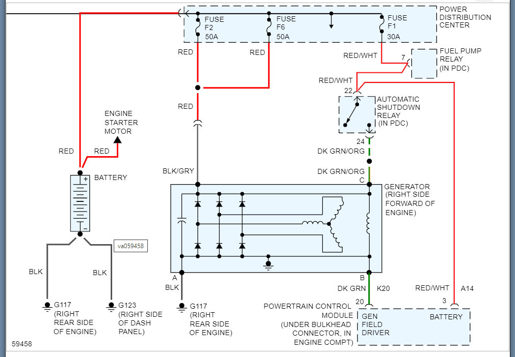

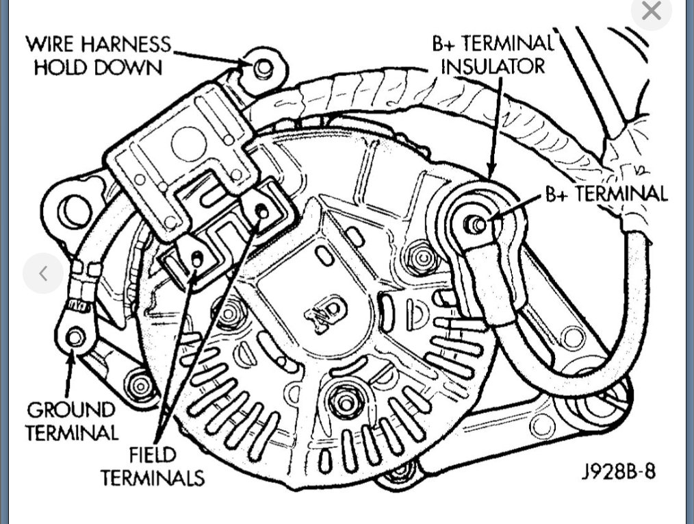

I have a 1994 jeep wrangler yj. I am having a brain fart and can not remember the locations on the wires on my alternator. That is where the wires connect to the alternator.

No problem. I am attaching the wiring diagrams and layout of the terminals.

Please see the attached info and let us know what other questions you have.

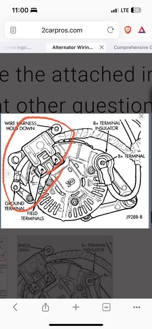

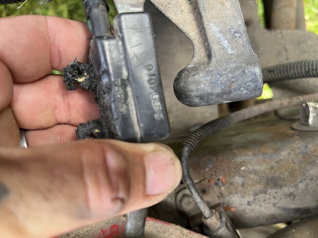

Hey. Thanks for this, I just got into a 1993 YJ (I’m totally a novice)
The existing wiring harness looks like it’s been chewed up and the two terminals are missing. Can anyone help me with an OEM part number or solution for wiring this new alternator?
I was thinking of trying to melt the plastic back and soldering terminals on the existing wiring harness but would like to just replace it if I can find it.

I would just cut the connector off and install new wiring connectors and attach them to the alternator. I don't think you will be able to find the wiring harness. FYI
