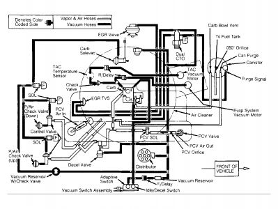

I have a 1990 Jeep Wrangler 4.2L that I have been trying to pass smog in CA. The Jeep has been running pretty good for an old vehicle and my mechanical experience has been growing vastly since I have had her. She is running 33's w/ stock gears.
Here are the Max and Gross polluter limits
15mph (HC-124(MAX)311(GP),CO-0.75(MAX)2.05(GP),NO-1020(MAX)1807(GP)) for
25mph (HC-104(MAX)261(GP),CO-0.95(MAX)2.25(GP),NO-880(MAX)1607(GP)).
Here are the results of my first test.
15 mph (RPM-1984, %CO2-13.9, %O2-1.0,HC-102, CO-0.53,NO-1965)GP
25mph(RPM-1902,%CO2-14.0, %O2-0.9,HC-105,CO-0.52,NO-1870)GP.
They said the high NO had to do with my EGR system. So I looked at it and the plastic nipple from the EGR temp switch was broken off, so the EGR had no vacuum. I fixed that w/ super glue and EGR gets vacuum and diaphram moves when revved.
Test2
15 MPH(RPM-1952,%CO2-12.3,%O2-0.6,HC-198,CO-3.44,NO-114)Gross P
25mph(RPM-1905,%CO2-11.9,%02-0.6,HC-201,C0-4.02,NO-99).
Now its running super rich. I went through all the vacuum hoses and replaced an re routed them per the vacuum schematic in my chiltons, and now she is idling super high, like 1300 RPM. I'm stuck, does anyone have any idea of what to do?
Apr 22, 2009 at 4:03 AM
RACEFAN966
  • 5,029 POSTS
OK here is a factory vacuum diagram. Check to make sure that everything looks right first ok. Then get back to me after that and let me know how it went.
https://images.2carpros.com/forum/automotive_pictures/249564_Graphic_76.jpg

After my second test I started to look at my vacuum hoses. They were not right at all. One line that was supposed to go to the rear of the carb was not there and the nipple on the carb was capped. I have since replaced most of the old vacuum hose and routed it the correct way. I also checked my timing and it was at 9 deg. so that is at factory setting. I still have to take it in for a third smog check.

Did the vacuum diagram I sent help at all as this is a factory diagram. How is the idle did it go back to normal? I would also say run a bottle of seafoam in the gas tank to clean anything out before the test too. Get back to me.

Ok have you checked the map sensor at this point? How is the PCV system is the valve working? DId you check the vacuum diagram that I included to make sure everything was correct? Get back to me thanks.

I don't think I have a map sensor. The PCV valve is new and I used the same vacuum diagram. I hope its not the cat.
