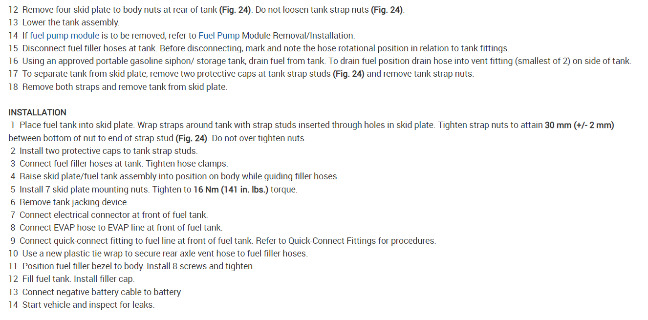

97 Wrangler Sport 157k miles. 5 Spd. I was in 4th gear, driving locally. The Jeep bogged and the check engine light came on. When I stopped, it stalled. Later int he day, I restarted it, the light was off. Next morning it wouldn't start.

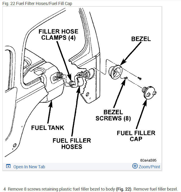

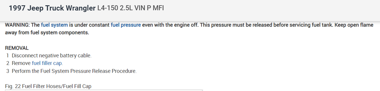

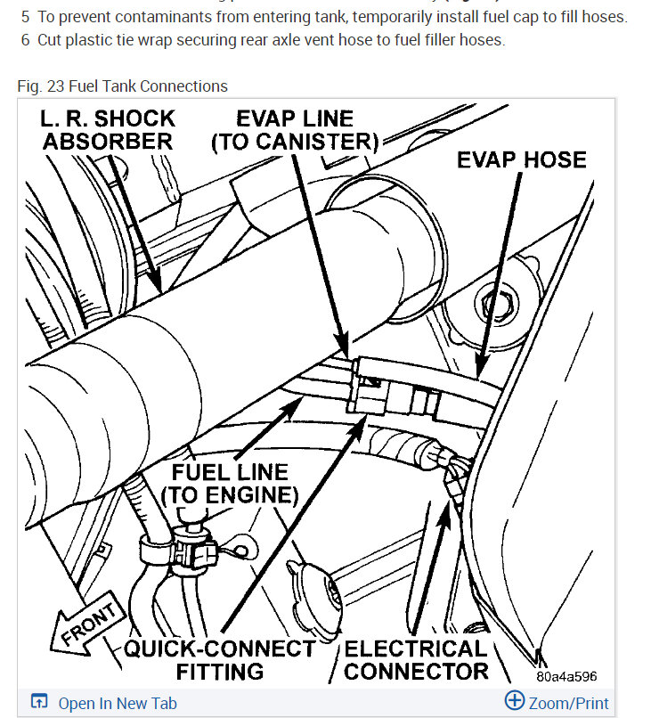

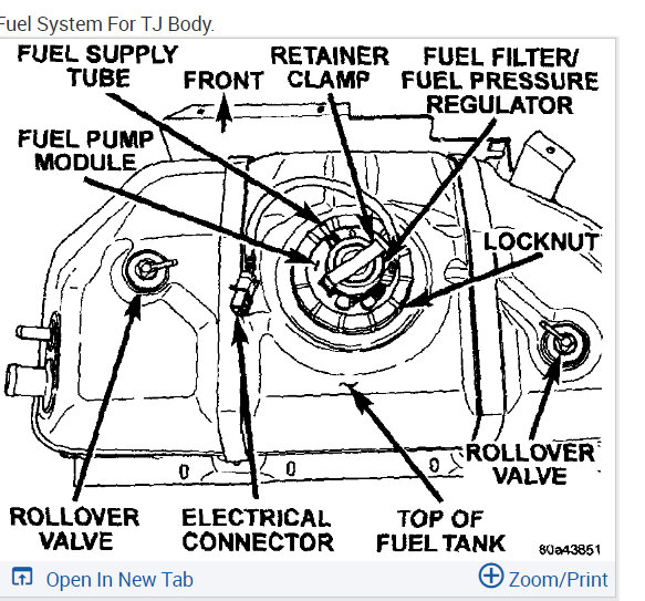

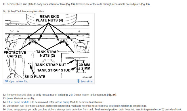

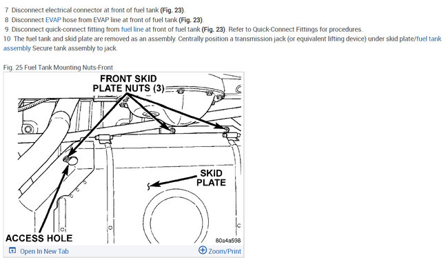

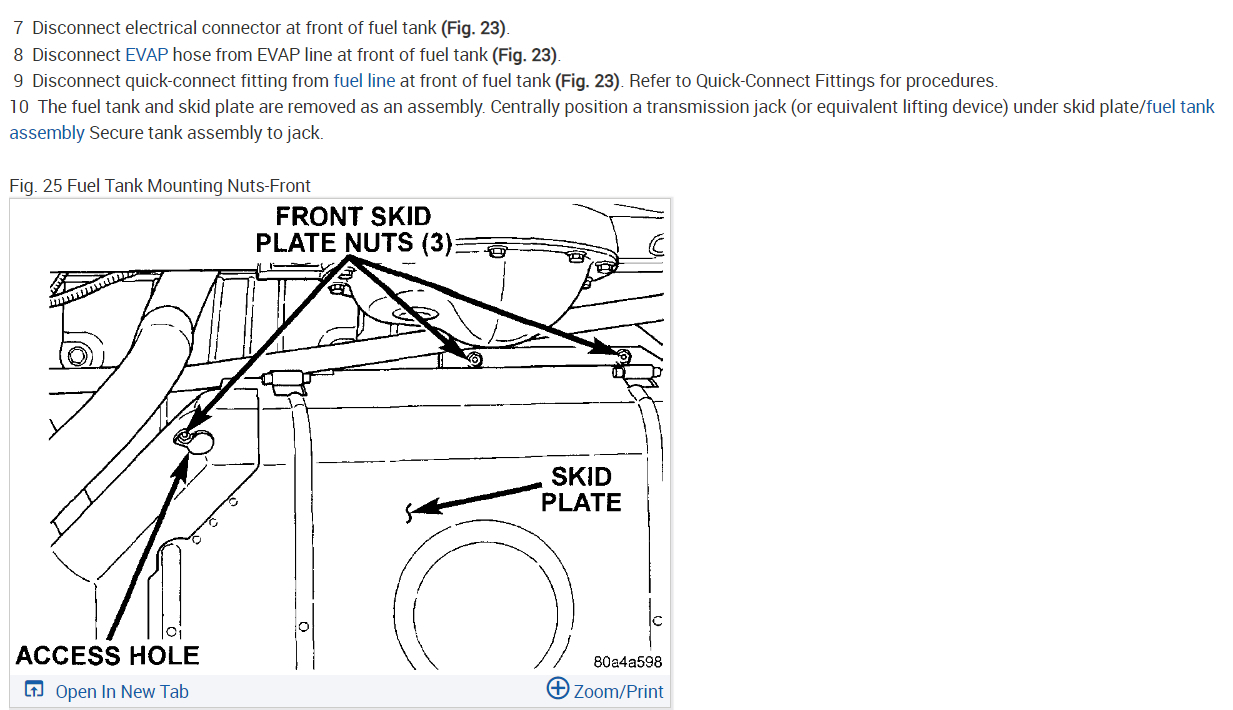

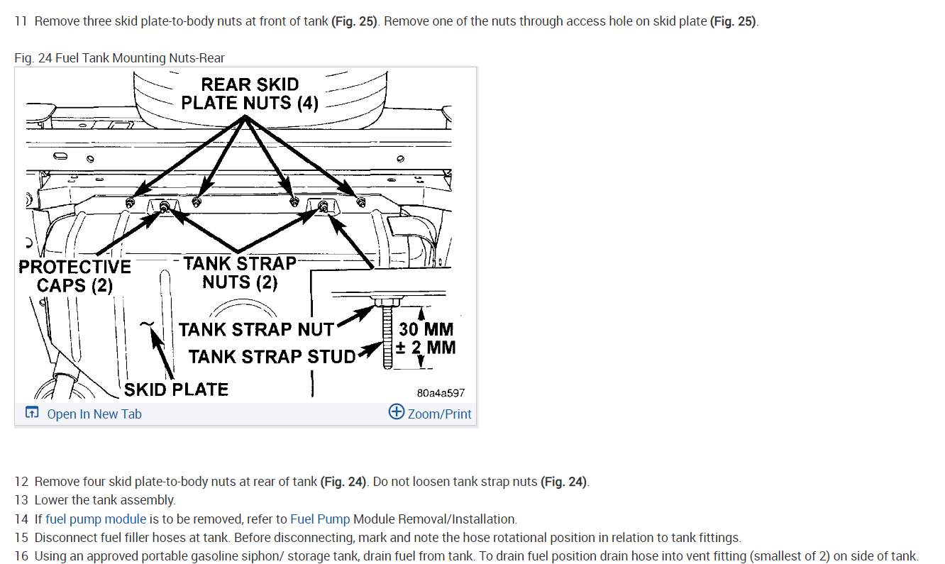

The best thing you can do is get the codes read, this will point you in the right direction to fix it. This guide can help
If you get a lean code it sounds like the fuel pump is going out, here is how to change it out to fix the problem. Check out the images (below). Let us know how it goes
