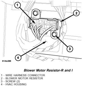

i have a problem with the blower motor switch which only works on high speed (the other 3 positiond don't work). From everything I have read the problem points to the blower motor resistor...there in lies the problem. Where is the resistor located? Everyone says it is behind the glove box, if so, Where...any help will be greatly appreciated.

Blower Motor Resistor Block Near HVAC harness

You probably have to remove the glove box completely but it's in there.
https://images.2carpros.com/forum/automotive_pictures/561653_Blower_resister_06_wrangler_1.jpg
