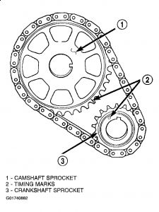

Iam putting a 4.0 inline 6cyl in my jeep. I bought a long block. I have the timing marks lined up ,but need to know , this does not have a distrubtor with wires. it has like a coil pack and what looks like a sending unit where the distribator goes. is there some steps to take to make sure it's in the right way? Thanks

Hi When marks line up engine at TDC # 1 cyl see diagram
https://images.2carpros.com/forum/automotive_pictures/198357_Graphic_268.jpg
Rotate crank two times marks should line back up your good to go. Hope this helps Thanks for donate
