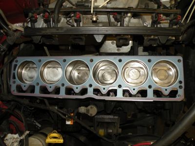

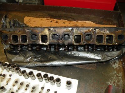

I have a 2002 Jeep Wrangler with an inline 6 cylinder engine. It started to make a tapping noise from the lifters. It's really noisy when I first start it up and quiets down after 15 minutes or so. I have used the engine flush which seemed to help a little. I also tried a thicker motor oil and that seemed to help but these two options didn't fix the problem. I am thinking it's a sticking lifter. I removed each rocker arm and pushed down on the push rods and the lifters seemed to be strong as I couldn't budge them.
Should I try more engine flush, I've done this three times now, or install a higher volume oil pump? My last option would be replacing the lifters and the manual says I have to pull the head off to remove them. Is there no way to remove them with the head still on?

My Jeep has been running superb since I bought it. I only had one issue about a month after I bought it, the check engine light came on.
I was like, WTF, hooked it up and computer said check gas cap and sure enough it was not tight. LOL.
Then about six months ago I decided to switch to synthetic oil, yes you can ask what was I thinking.
That's when I started noticing the tapping or clattering. I guess the synthetic oil cleaned out the sludge because I dropped the oil pan, by the way you don't have to break motor mounts loose for clearance like the manual said I had to do, and it had a fair amount of sludge in it. I thought maybe it was clogging the oil pickup. I cleaned it all out, took the pump off and cleaned it also.
Changed back to conventional oil, now I'm running 10w30 and also using Wix filter. Seemed to help as the noise seemed to go away. Then one day I started the engine in the morning and there was that confouned tapping again. It does quiet down after a few minutes. That's when I decided to clean the engine with MMO.
I used it per the instructions on two seperate occasions with no luck.

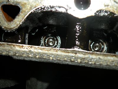

That's when I decided to pull the valve cover and try and inspect the lifters the best I could, that's why I asked about pushing the push rod for down by hand, someone told me if you can then the lifter might be bad, I'm kinda lost in that area of knowledge.
The noise was and is coming from the last two cylinders, not an exhaust leak.
I found the procedure for pulling the rockers arms and did it one cylinder at a time, making sure to put everything exactly back the way I took them off. I removed the push rods and the front ones had a little build up on them. The last four had, what I would call, excessive build up on them.
I cleaned them all off and even went as far as pouring some MMO directly on top off each lifter hoping that would help.
I put it all together and put in the rest of the MMO and filled it with 10w30. I started it up and "voila" no noise. I patted myself on the back and said good job.
The next day I get ready to go to work and start it up and, what do you know, there's that infernal tapping again. I am assuming that there's sludge and its clooging the lifter and not letting it pump up properly. The thing is, that the last few days it comes and goes. Sometime it will tap and sometimes it won't. I am going to run some MMO through the engine this weekend and see what happens.

OK, Now for some possible scolding/ learning!
Any time you remove any part of anything! , always keep it seperate, which end was where, so that it can be reassembled, EXACTLY as it came apart!
Why?
This stuff is "worn in" or MATED to the surface it Meshed with...Understand?
Changing, means they are no longer mate with their mate, and must Wear in again, possibly CHANGING heights or distances or sealing surfaces, Not a good thing, maybe not a real drastic thing, JUST DON"T DO IT AGAIN!
Remove valve cover, when we are clattering, RUN engine, FINGER your rocker arms,(on the pushrod side) Push hard while running, make the clatter ease off, one pushrod at a time
IDENTIFY NOISY ONES
Go to auto machine shop (Not AUTO STORE) We are looking for a guy that understands "thousandths" and operation, not the former McDonaldland window guy!
Ask him if they make a pushrod(s)----(All may be the same, intake and exaust may be different)----Ask him if you can GET/ RUN/USE a pushrod---A FEW THOUSANDTHS LONGER, AND REPLACE THE NOISY ONES
I do not see a problem myself, this should not affect lifter operation, unless you get too long
It would let your lifters "re-adjust" deeper in the tappet
Let me know what he says

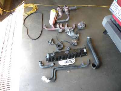

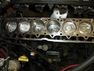

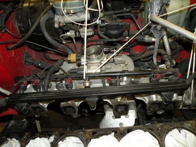

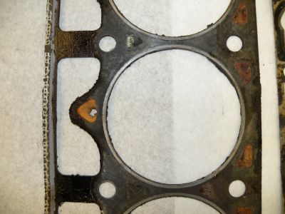

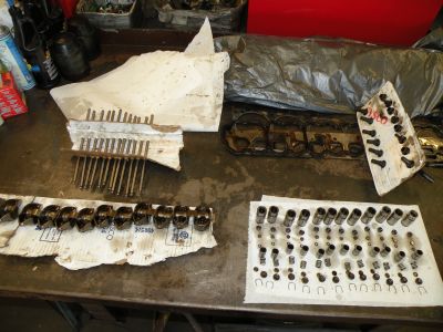

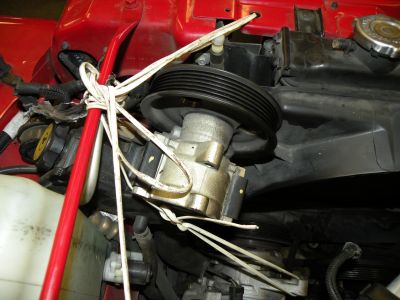

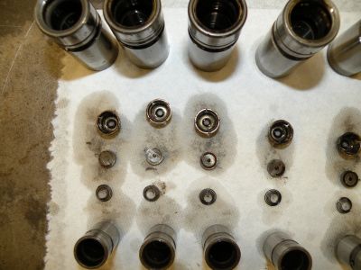

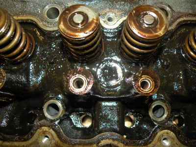

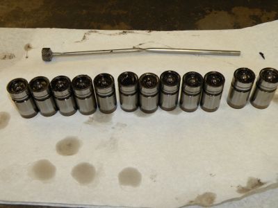

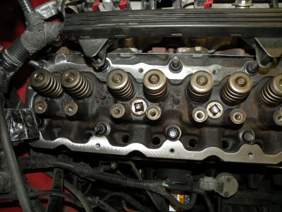

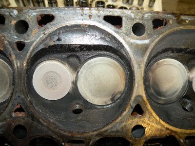

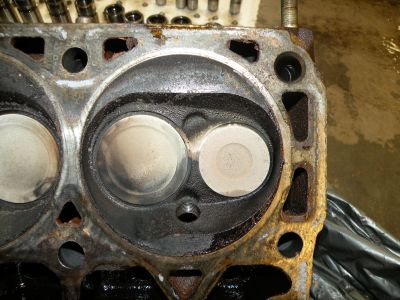

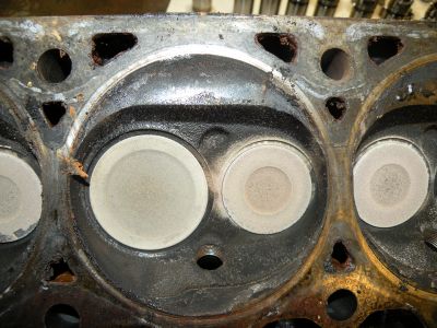

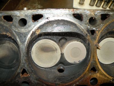

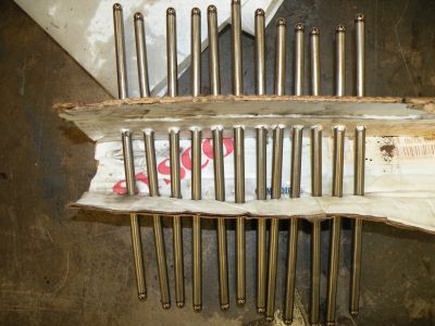

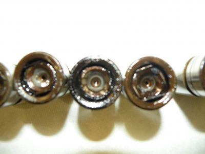

Push rods were fine ( had them checked). Replaced lifters and no more noise, except the usual jeep noise.
https://images.2carpros.com/forum/automotive_pictures/519524_DSCN1101_1.jpg
https://images.2carpros.com/forum/automotive_pictures/519524_DSCN1103_1.jpg
https://images.2carpros.com/forum/automotive_pictures/519524_DSCN1105_1.jpg
https://images.2carpros.com/forum/automotive_pictures/519524_DSCN1112_1.jpg
https://images.2carpros.com/forum/automotive_pictures/519524_DSCN1125_1.jpg
https://images.2carpros.com/forum/automotive_pictures/519524_DSCN1137_1.jpg
https://www.2carpros.com/forum
/automotive_pictures/519524_DSCN1157_1.jpg
https://images.2carpros.com/forum/automotive_pictures/519524_DSCN1167_1.jpg
https://images.2carpros.com/forum/automotive_pictures/519524_DSCN1180_1.jpg
More pics to come...............

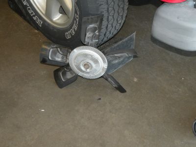

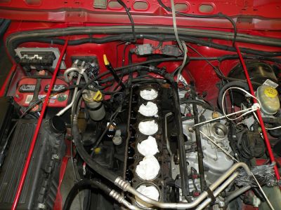

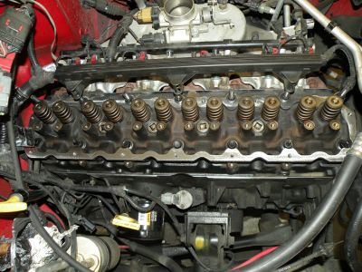

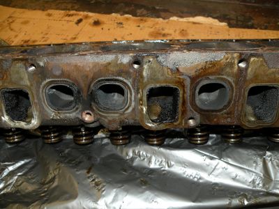

May 2, 2010 at 9:54 PM
12PAUL12
  • 10 POSTS
https://images.2carpros.com/forum/automotive_pictures/519524_DSCN1149_1.jpg
https://images.2carpros.com/forum/automotive_pictures/519524_DSCN1202_1.jpg
https://images.2carpros.com/forum/automotive_pictures/519524_DSCN1203_1.jpg
https://images.2carpros.com/forum/automotive_pictures/519524_DSCN1204_1.jpg
https://images.2carpros.com/forum/automotive_pictures/519524_DSCN1205_1.jpg
https://images.2carpros.com/forum/automotive_pictures/519524_DSCN1206_1.jpg
https://images.2carpros.com/forum/automotive_pictures/519524_DSCN1207_1.jpg
https://images.2carpros.com/forum/automotive_pictures/519524_DSCN1208_1.jpg
https://images.2carpros.com/forum/automotive_pictures/519524_DSCN1209_1.jpg
https://images.2carpros.com/forum/automotive_pictures/519524_DSCN1210_1.jpg
https://images.2carpros.com/forum/automotive_pictures/519524_DSCN1211_1.jpg
https://images.2carpros.com/forum/automotive_pictures/519524_DSCN1214_1.jpg
https://images.2carpros.com/forum/automotive_pictures/519524_DSCN1215_1.jpg
https://images.2carpros.com/forum/automotive_pictures/519524_DSCN1216_1.jpg
https://images.2carpros.com/forum/automotive_pictures/519524_DSCN1218_1.jpg
https://images.2carpros.com/forum/automotive_pictures/519524_DSCN1219_1.jpg
https://images.2carpros.com/forum/automotive_pictures/519524_DSCN1220_1.jpg
https://images.2carpros.com/forum/automotive_pictures/519524_DSCN1226_1.jpg
https://images.2carpros.com/forum/automotive_pictures/519524_DSCN1238_1.jpg
https://images.2carpros.com/forum/automotive_pictures/519524_DSCN1240_1.jpg
https://images.2carpros.com/forum/automotive_pictures/519524_DSCN1241_1.jpg
https://images.2carpros.com/forum/automotive_pictures/519524_DSCN1242_1.jpg
https://images.2carpros.com/forum/automotive_pictures/519524_DSCN1244_1.jpg
https://images.2carpros.com/forum/automotive_pictures/519524_DSCN1246_1.jpg
https://images.2carpros.com/forum/automotive_pictures/519524_DSCN1247_1.jpg

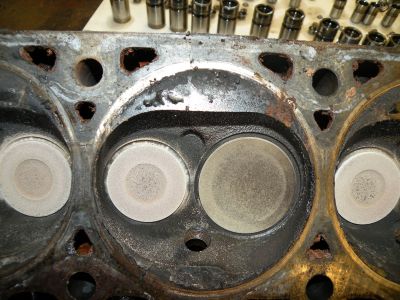

I do not know your "situation", I would not even attempt to take apart and clean the lifters! (fearing something would not be exactly right, after reassembly and start-up!). I always put new ones in, if I am that far into it! If you are reusing, what kinda wear was on the bottoms? I am guessing you did it, Just to see what was going on with 'em. (EDIT: sorry got carried away with the pics, I didn't see that you were replacing the Tappets!) NICE RIG !!! Has my contributionhelped you at all? I see the room you have in there, thats cool! I figure, once you get all that "Cyber Crap" off---theres nothing left in your way. Your engine compartment is red......CLEAN hood well. Go to a place that does Vinyl lettering...get this done professionally! I spray-bombed my compartment, when the engine was out, and hand painted this on mine! (next step is Toyota, Chevy and Dodge logos, bites in/out of them, on magnetic backing, in the teeth!) I like Ford, will leave them out of this!
https://images.2carpros.com/forum/automotive_pictures/411289_100_0327_1.jpg
Keep me informed, you seem to be very concious and tedious with your work. Love, Turddog

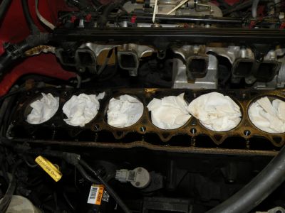

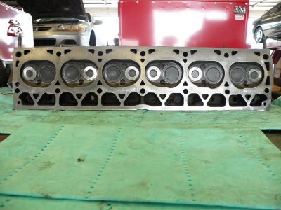

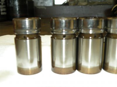

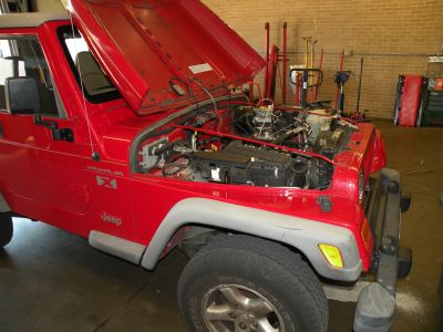

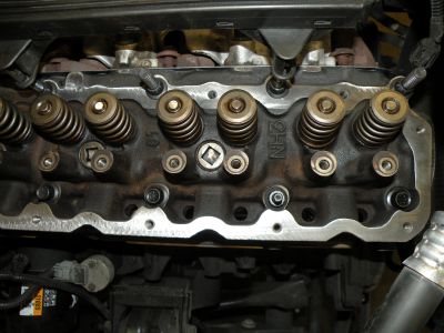

I did replace the tappets. More pics to come on that.
Funny story.

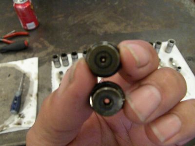

I went to my local parts store to buy some new tappets.
They only had four in-stock and said they could get the rest the next day.
I talked to a friend (mechanic type) and he said he could get them and have them shipped to the parts store.
The next day I go to pick them up and proceed to the shop to install them.
I open the boxes and there are two different kinds in the boxes.
One was stamped HT-2011 and one was stamped JB-2011.
The boxes were all labeled JB-2011.
I find out that they both will work for my 4.0L engine.
I didn't want to take any chances as the JB-2011 outer sleeve was almost 1/16 of an inch taller and had different springs inside (I actually took both kinds apart to see).
I called them back and they were certain that they gave me all the same kind, so I went back and showed them that they were stamped with two different part numbers.
They called a few different stores and the next day I had twelve of the same kind, HT-2011's.

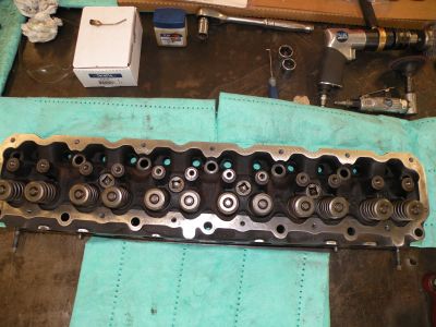

I took them to another mechanic to have them "pre-oiled" to prevent any excessive wear during the re-start.
I installed them and used plenty of assembly lube.

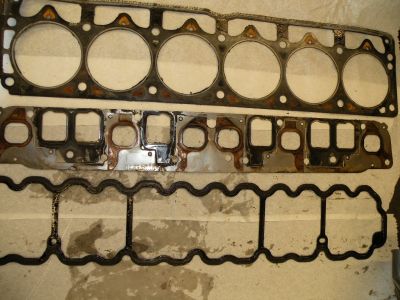

New gaskets, new tappets, new thermostat and thermostat housing (the old one had a hole eaten through where the heater core mount is.), new drive belt.
A pretty straight forward job for a novice like me.
For less than $250.00.
All-Data is pretty awesome and it even has pictures!
The only part that was somewhat hard was the intake and exhaust manifolds as they are three separate pieces but they all bolt on the head together with 15,...... 15!, that's right 15 bolts!

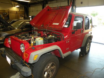

I get everthing put back together and go to start 'er up.
I have my fingers crossed and my eyes shut.
I turn the keys and presto it fires right up and runs great.
Now it only makes the familiar Jeep noises I have grown to love.
Once again my Jeep is happy as am I.

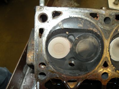

May 3, 2010 at 7:59 AM
12PAUL12
  • 10 POSTS

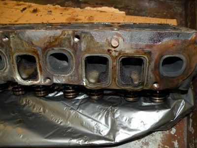

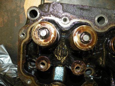

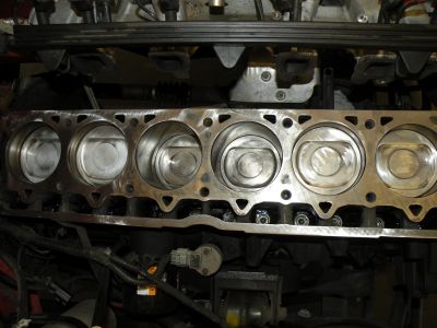

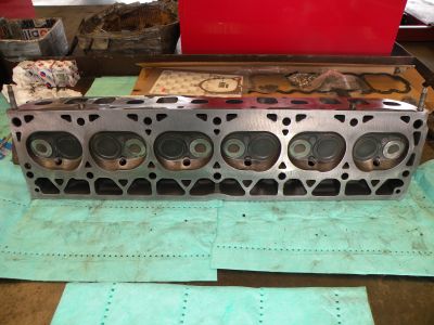

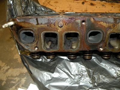

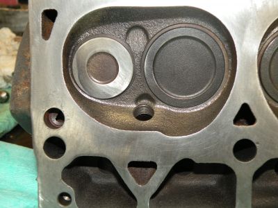

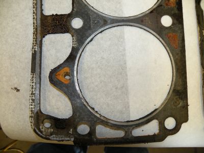

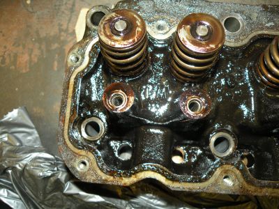

You tell me, Is this head new or used?
https://images.2carpros.com/forum/automotive_pictures/519524_DSCN1254_1.jpg
https://images.2carpros.com/forum/automotive_pictures/519524_DSCN1257_1.jpg
https://images.2carpros.com/forum/automotive_pictures/519524_DSCN1260_1.jpg
https://images.2carpros.com/forum/automotive_pictures/519524_DSCN1261_1.jpg
https://images.2carpros.com/forum/automotive_pictures/519524_DSCN1256_1.jpg
https://images.2carpros.com/forum/automotive_pictures/519524_DSCN1255_1.jpg
https://images.2carpros.com/forum/automotive_pictures/519524_DSCN1259_1.jpg
So shiny I can see myself...........
https://images.2carpros.com/forum/automotive_pictures/519524_DSCN1252_1.jpg
https://images.2carpros.com/forum/automotive_pictures/519524_DSCN1253_1.jpg
https://images.2carpros.com/forum/automotive_pictures/519524_DSCN1258_3.jpg
And if you look closely you can see the new tappets installed.
May 4, 2010 at 5:47 PM
CJ MEDEVAC
  • 11,004 POSTS
It looks INCREDIWONDERFUL!, How many times have you ever took on a job of this proportion?
You did incredibly well, keeping your stuff in that organized of an order, really helps with precision re-assembly--clean (yours spotless, no micro-organisms, going back in!)--and makes---YOU--- look very professional.
Better than most pro shop do!
I try to explain in Country-Boy Lingo, Textbook is sometimes hard to comprehend.
It sometimes takes me several times, and periods of time....For me to process this stuff into my own, understandable version (for me) Before I can pass it on!
I WANT TO BE THE FIRST ONE, TO RECEIVE A WRANGLER DENTAL PHOTO!
Love, Turddog
