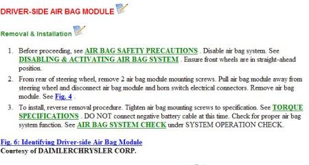

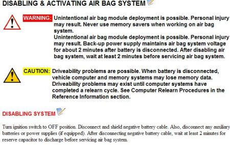

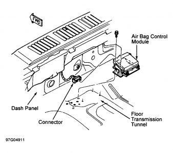

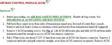

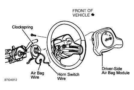

WOULD LIKE KNOW HOW TO UNPLUG DRIVER SIDE AIRBAG
Nov 29, 2008 at 9:44 AM
MHPAUTOS
  • 31,937 POSTS
Air bag infomation.
