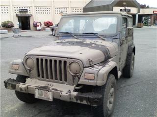

I'm new to the working on vechicle world... Literally... So if I do all that you sugusted I can come pretty close to or better with 22mpg. I'm just trying to make sure, I'll take gas milage over all else. Thanks I'll still besble to play in the mud right?

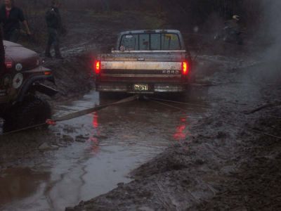

And got get stuck like this guy?

You will probably gain anywhere from 10 - 30 bhp from these upgrades as well as better gas milage. If you don't want to get stuck in the mud then the key there is torque. You want the highest ratio gears possible in the mud. A ring a pinion change will ensure this along with mud terrrain tires for traction and a lift kit to keep the car from becoming too bogged down in the mud.
