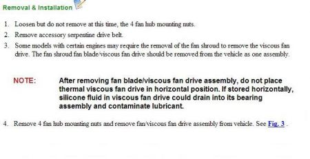

Hello and thanks for the donation!
Below is the information you requested..

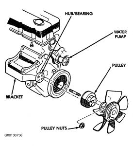

FIGURE 3
Jun 16, 2009 at 9:26 PM
JEEPBOY
MEMBER
4 POSTS
THIS DID NOT HELP AS YOUR DIAGRAM IS DIFFERENT THAN MY VEHICLE. THERE IS A LARGE NUT BETWEEN THE PUMP AND FAN. YOUR DIAGRAM IS WRONG

What type of Jeep Wrangler do you have? Wrangler Sport etc...? Engine size? 3.0L etc..?
Jun 16, 2009 at 9:43 PM
JEEPBOY
MEMBER
4 POSTS
SPORT 4.0

WE GOT IT OFF (A HAMMER HELPED). PERHAPS AN ANSWER TO THE QUESTION OF NO OIL PRESSURE. I HAVE REPLACED THE OIL SENDING UNIT AND THE GAUGE DOES'NT MOVE BUT THE JEEP RUNS FINE

Here is a pic of the tool for removing the Fan Clutch off the Water Pump...
