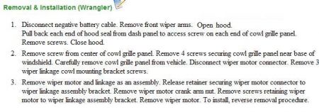

what is the easiest way for a semi mechanical person to change a wiper motor what tool will i need specific instructions are a great help

https://images.2carpros.com/forum/automotive_pictures/261618_Noname_1093.jpg
