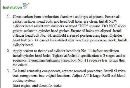

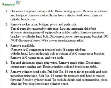

What are the proper steps in replacing a blown head gasket?
