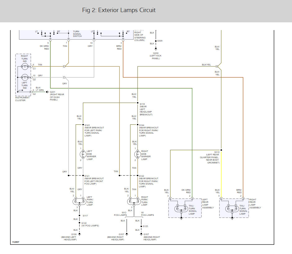

Something is wrong with my turn signals. when i turn left it works fine. when i turn right it comes on as if my hazards are on an one of the bulbs doesn't work. i tried replacing the bulb but it still doesn't work and the problems still there. also when i turn my hazards on or turn right my dash board and gauges blink with the signals. what is wrong and what do i need to do

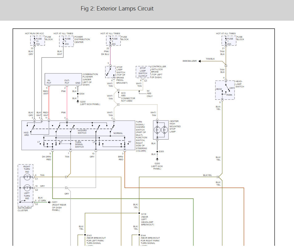

it sounds like the turn signal switch is bad but to be sure here are the blinker wiring diagrams and a guide to help test it.
Check out the diagrams (Below). Please let us know what you find. We are interested to see what it is.

Thanks for this post I had this problem and used to guide to tell the turn signal switch has bad got a new one for $112.00 all fixed! I love this site.

My right turn signal and brake light is not working . The tail lights work . I have replaced the bulb and it still is not working

Bad bulb socket or bad ground. The front turn and park light work?

Yes front turn stays steady but does not blink all parking lights work . I was thinking ground because I put a test light on it and it has power . Should I take the housing off and clean the screws? All the wires seem to be ok.

Replace the turn signal flasher they are not expensive and can be purchased at you favorite parts store.
