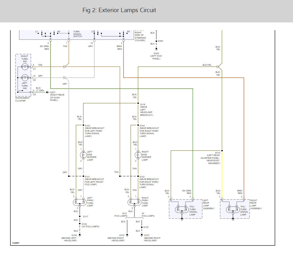

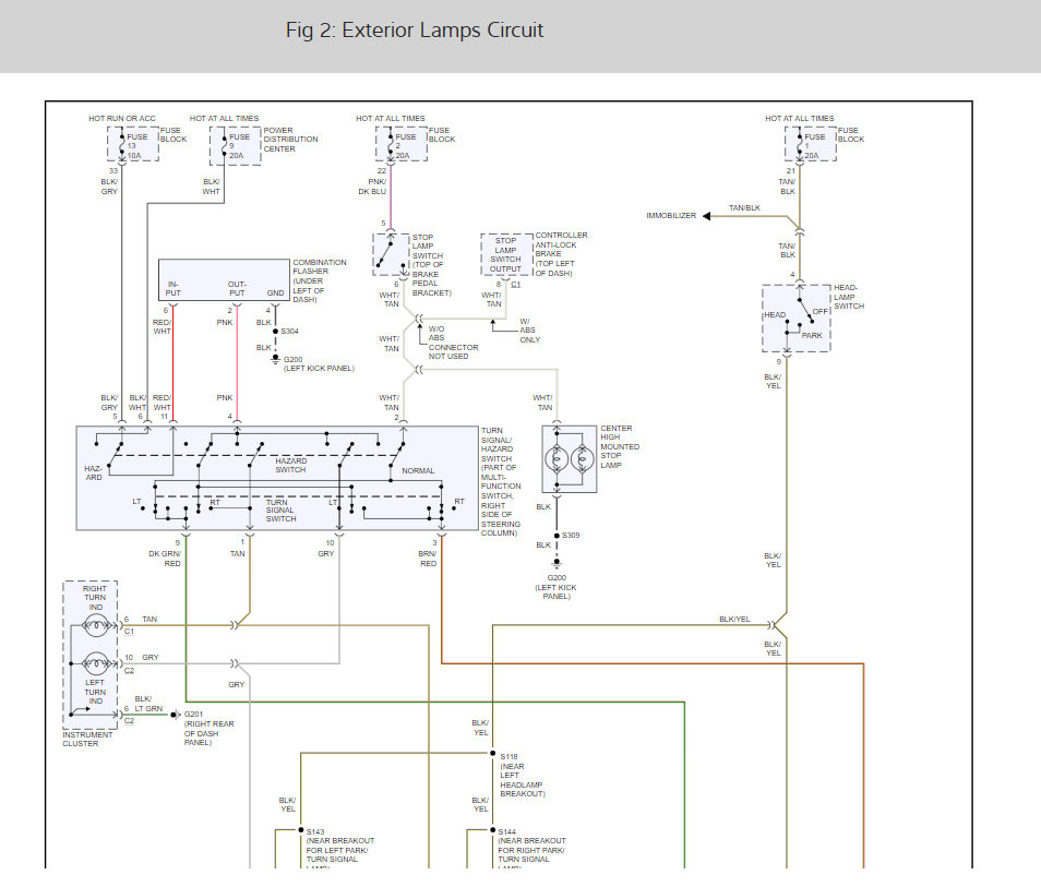

Something is wrong with my turn signals. when i turn left it works fine. when i turn right it comes on as if my hazards are on an one of the bulbs doesn't work. i tried replacing the bulb but it still doesn't work and the problems still there. also when i turn my hazards on or turn right my dash board and gauges blink with the signals. what is wrong and what do i need to do

it sounds like the turn signal switch is bad but to be sure here are the blinker wiring diagrams and a guide to help test it.
Check out the diagrams (Below). Please let us know what you find. We are interested to see what it is.

Thanks for this post I had this problem and used to guide to tell the turn signal switch has bad got a new one for $112.00 all fixed! I love this site.
