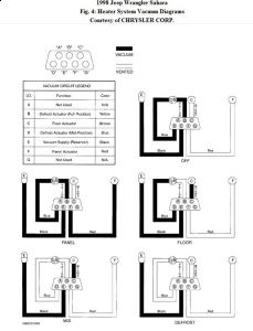

1998 Jeep Wrangler 6 cyl Four Wheel Drive Manual
Heater vents only through the defroster in any selection of the control. My vehicle only has a heater unit no AC. Heat comes out fine. I replaced the heater control assy. What else can I replace?
Nov 20, 2009 at 8:08 AM
KHLOW2008
  • 41,812 POSTS
Hi sfcjdherrera, Thank you for the donation. Check the vacumn hoses. Loss of vacumn hoses woulnd not allow the vents to operate correctly.
https://images.2carpros.com/forum/automotive_pictures/192750_Heater98WranglerGif04_1.jpg
Check the temperature control cable and blend air door movement.
