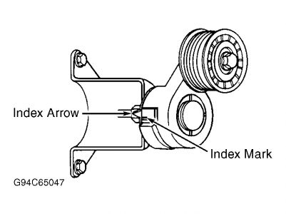

1997 Jeep Wrangler how to put on the belt ?
1997 JEEP WRANGLER
TANKWOODY1776
Engine Cooling problem
1997 Jeep Wrangler 6 cyl Four Wheel Drive Automatic
How to you get the belt to go on. Do you unscrew something or pull on something so the belt will slip on ? I have the belt routing diagram

Here is a picture of the automatic tensionier. Place a box end wrench on the pulley bolt and turn it to move the thensionier and loosten the belt.
https://images.2carpros.com/forum/automotive_pictures/249084_Jeep_Wrangler_94C65047_1.jpg
Let me know if this helps. Joe
