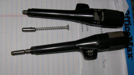

how do i remove broken piece of turn signal lever still in multi switch

Drill a small hole in the broken piece, then thread a wood screw into it. Pull out with pliers
https://images.2carpros.com/forum/automotive_pictures/414487_P9270001_1.jpg
