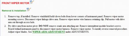

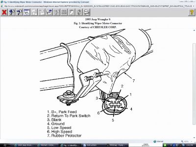

How do I remove the wiper motor. Does anyone have a diagram?

This is what I came up with...
https://images.2carpros.com/forum/automotive_pictures/62217_Wiper_1.jpg
https://images.2carpros.com/forum/automotive_pictures/62217_Wiper2_1.jpg

This is all they give for alldata
1. Disconnect negative battery cable.
2. Lift wiper arm until holes in arm and arm base align, insert a pointed tool through holes to lock arm, then grasp arm near base and rock arm while pulling up to remove.
3. Remove top and top components sufficiently to allow windshield to fold forward.
4. Remove windshield retaining bolts at lower corners of instrument panel and fold windshield forward.
5. Remove three torx head wiper motor mounting screws, then disconnect wiring harness clip from base of windshield.
6. On models with intermittent wipers, remove mounting screws from intermittent module bracket at base of instrument panel.
7. Disconnect wiring harness clip from base of windshield.
8. Remove plastic cover over access hole in windshield frame, if equipped, then pry drive arm off wiper linkage.
9. Remove seal to windshield frame screws, that may interfere with drive arm and motor removal.
10. Pull drive arm and motor from windshield frame.
11. Pry drive arm from motor pivot.
CAUTION:
Do not remove nut holding pivot to motor shaft.
12. Reverse procedure to install. Torque motor mounting screws to 96 inch lbs.
