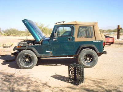

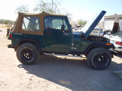

i,am not getting any power to the computer,and can not locate the power wire for it.the book says that the power wire is yellow, but there is not a solid yellow wire going to the computer.[img:cefeef9574]http://www.2carpros.com/forum/automotive_pictures/307869_my_jeep_007_1.jpg[/img:cefeef9574]
[img:cefeef9574]http://www.2carpros.com/forum/automotive_pictures/307869_my_jeep_005_1.jpg[/img:cefeef9574]

At PCM term. #3 Red/White wire 12v key on
trem #6 Violet?White 5v
term #8 Orange 8v
Check ASD auto shutdown relay in power distribution center under hood.
