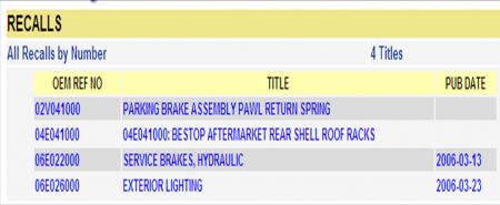

Hello - By the way..........I did think of one other thing and searched through about 50 TSBs seeing if there was a logged problem........didn't see one. But - you may have some recalls on your vehicle. The dealer may fix these for free. Please contact the dealer service department, give them the VIN number of your car and have them check on these to see if they apply to you.
https://images.2carpros.com/forum/automotive_pictures/248015_Recalls_3.jpg
