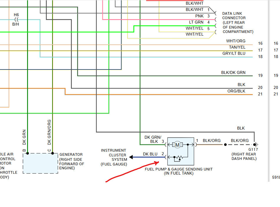

I broke my clips to connect my 1993 jeep wrangler 4.0L to the fuel sending unit and i cannot figure out how the wires go together to make it work again. So my question is what wires do i connect to get it to work? The important thing is get it to run but i cannot figure out how to combine the wires to make it run. Any help will be appreciated
Thank You
Adam

Ok first I would see if I could buy a new pigtail either from the dealer or wrecking yard. I did include a pic of the wiring that does include the sending unit and fuel pump operation I hope you can read it ok. It looks like there are three wires. Check out the images (below). Let us know if you need anything else.
