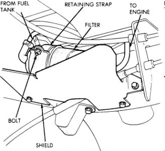

Where is the fuel filter located? jeep runs good 1st through 3rd gear but in 4th and 5th at @2500 rpm it looses power and starts to backfire
Mar 14, 2010 at 11:47 AM
  • 75,992 POSTS
The fuel filter is located under the vehicle along the drivers side frame rail, and is covered by a shield.
