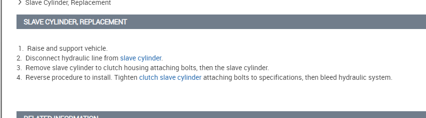

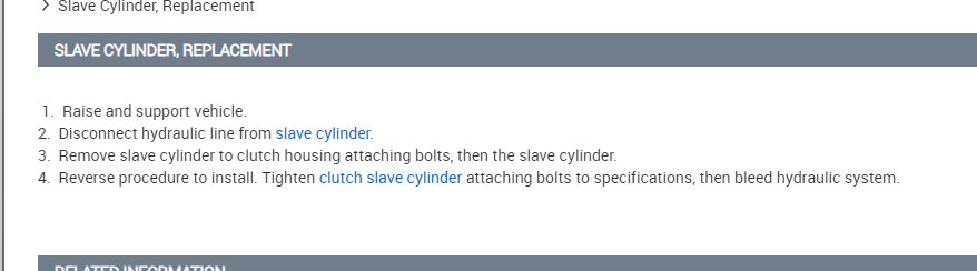

Please see the attached info below. It is not that detailed so please use the guides above to help.
Let me know what questions you have.
