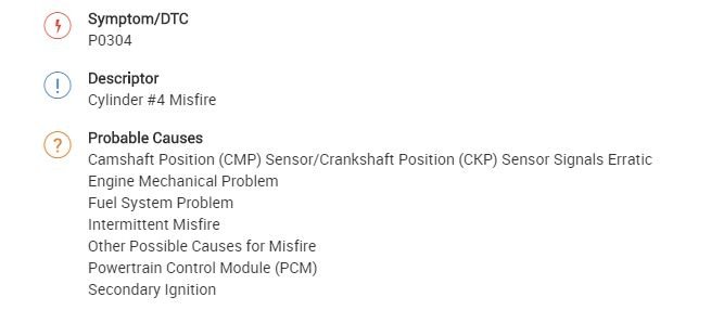

TESSA HOLMES
PO3O6, PO3O5, PO3O4
I believe were the codes.
Jan 8, 2020 at 3:28 AM

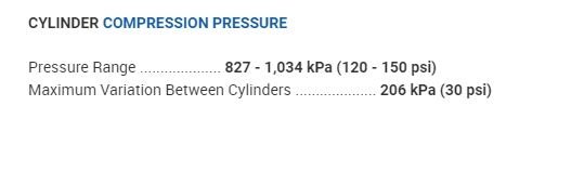

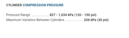

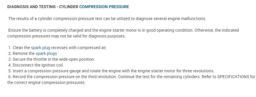

Okay, thanks.
They are misfire codes for the engine cylinders 4,5 and 6.
You would need to do a compression test first to be sure there are no engine issues internally with the motor itself.
