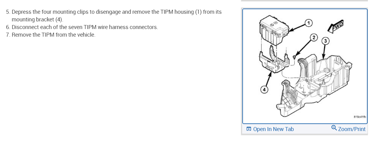

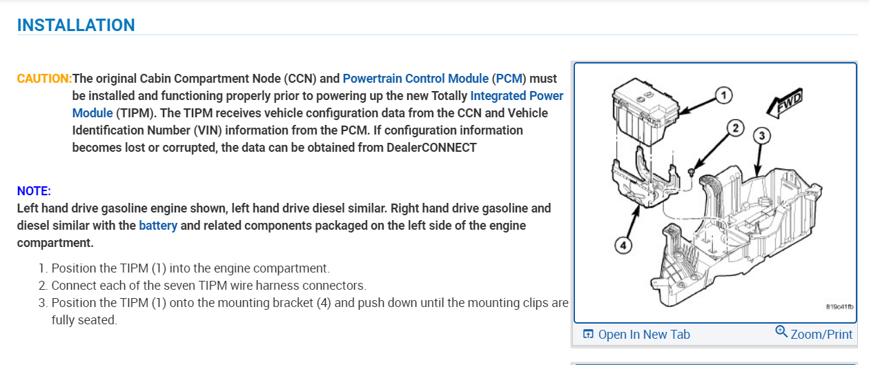

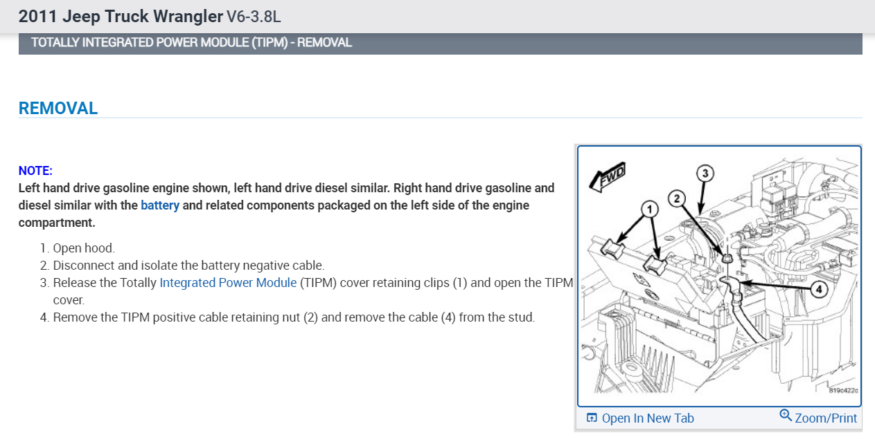

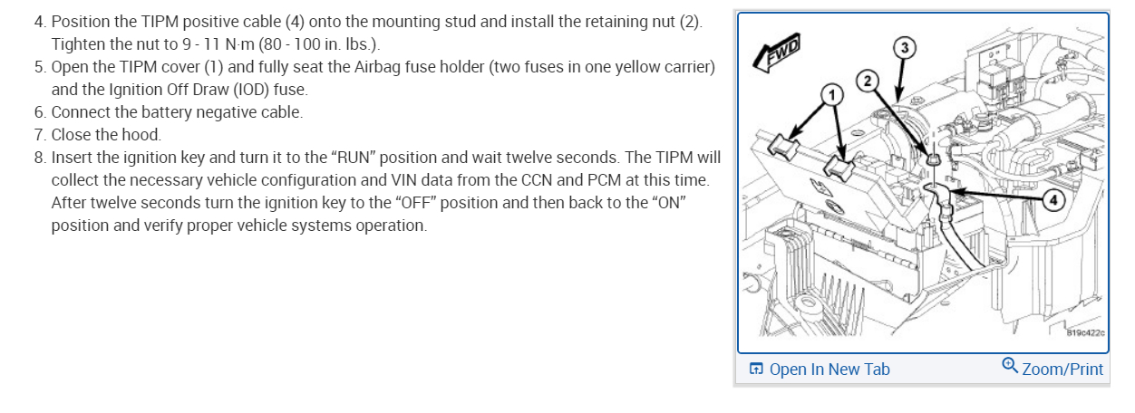

When you try to start the engine does the security light flash? If not, I have seen the TIPM module go out which is a big problem with Jeeps, it is easy to replace because it-self learns. Check the images below.
