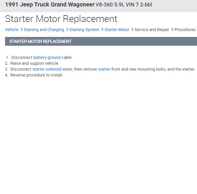

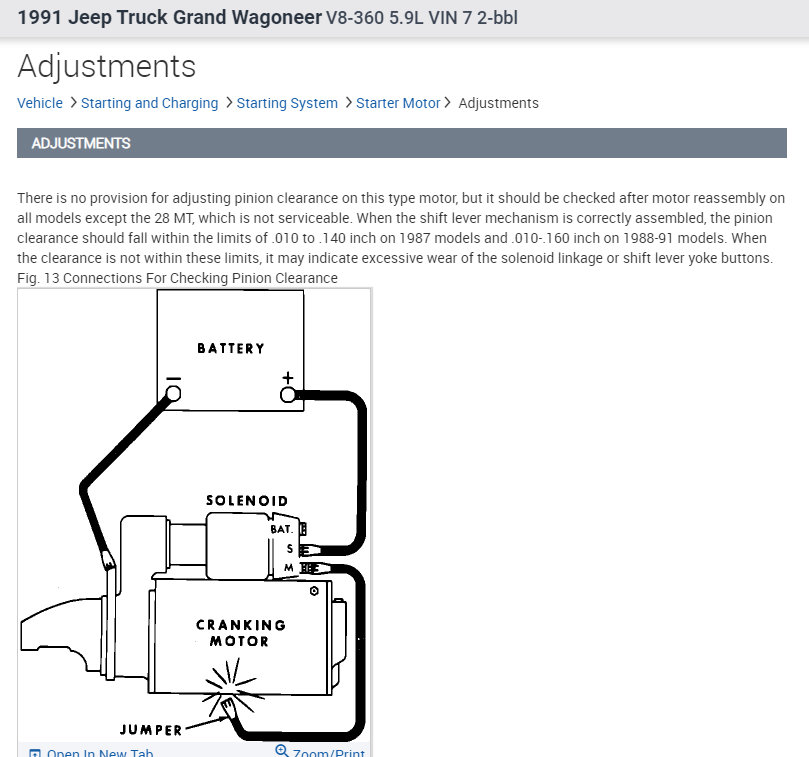

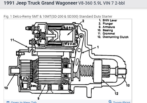

1991 Jeep Wagoneer V8 Four Wheel Drive Automatic
has good battery connection but it will not start i think it might be the starter or the solenid

If when trying to jump start the starter only clicks but not cranks over the engine, then it could be a bad starter or a weak / corroded connection to the starter.
Make sure the starter cable is secured and free of any corrosion.
