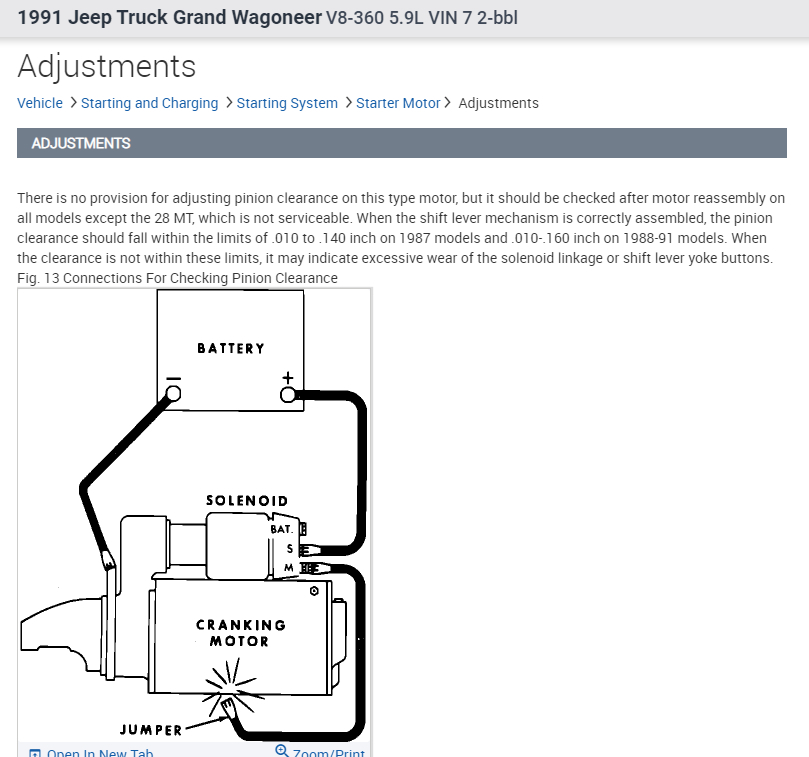

has good battery connection but it will not start i think it might be the starter or the solenid

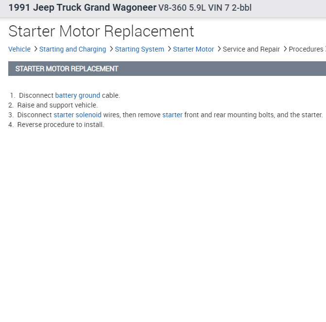

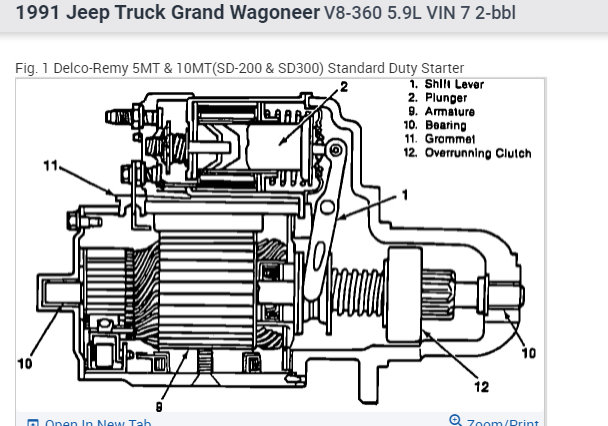

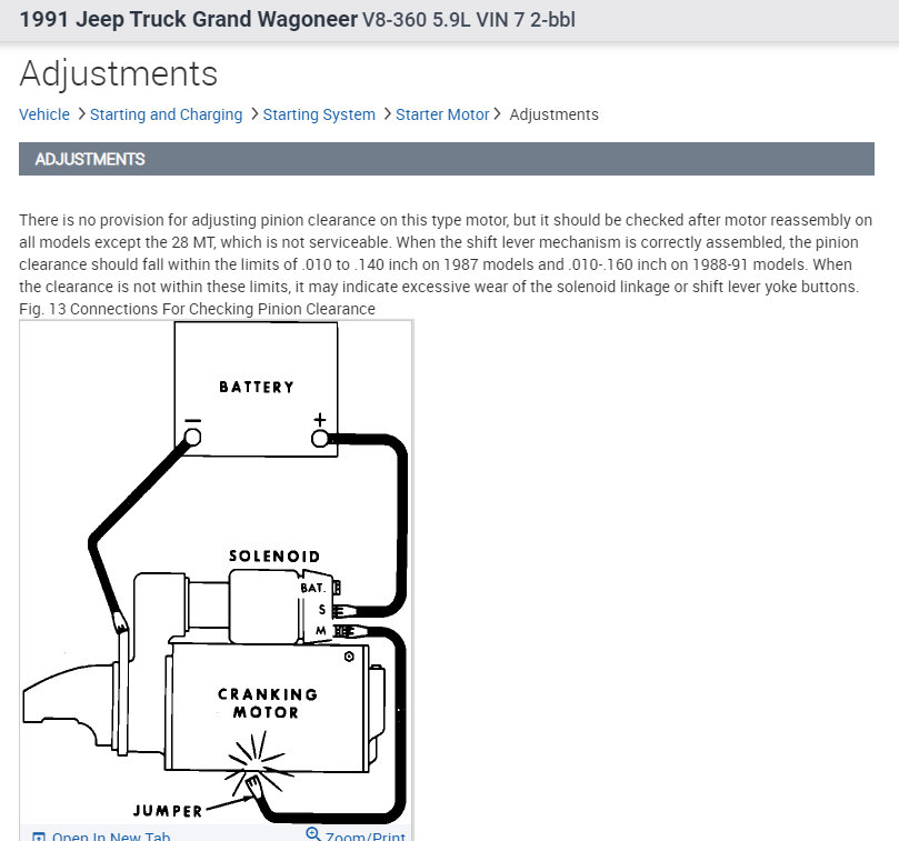

Just so cover the basics. Have you tried to jump start the vehicle? Many times, with a weak battery all the lights will come on, but it will only click when try to start the engine.
https://www.2carpros.com/articles/how-to-jump-start-car-battery-using-jumper-cables
If when trying to jump start the starter only clicks but not cranks over the engine, then it could be a bad starter or a weak / corroded connection to the starter.
Make sure the starter cable is secured and free of any corrosion.
