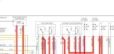

an accessory light was left on and the battery went dead. Car ran fine before this but now there is no spark, no fuel, but turns over fine. I have replaced the cap, rotor, plugs, fuel pump and crankshaft position sensor. Also I have swapped the ASD relay with a known working relay. Still no luck. Has anyone had this happen? What should I check next?

Hi randjen1, Welcome to 2carpros and TY for the donation I want you to check fuse no.20 in the power distribution center if okay -remove the fuse and get a jumper wire from the battery positive post to the coil dark green and orange wire this will power both the injectors and coil and let me know what happened.
https://images.2carpros.com/forum/automotive_pictures/12900_asd_relay_8.jpg

I ran the hot wire to the orange and green off the coil but nothing happened. What next?

I don't have a reference on this Jeep TJ non listed -what I was using is for Cherokee SE-okay do you have power to the coil when you turn the key On and also do you hear the fuel pump come On?

no power to coil and fuel pump not coming on

I ran the hot wire to the orange and green off the coil but nothing happened. What next? -When you did this and crank engine over do you have spark coming out of the plug wires if not I recommend you have the computer checked out
