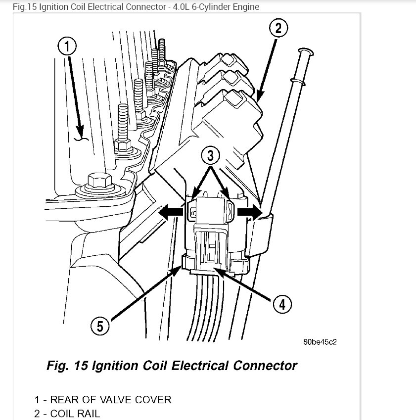

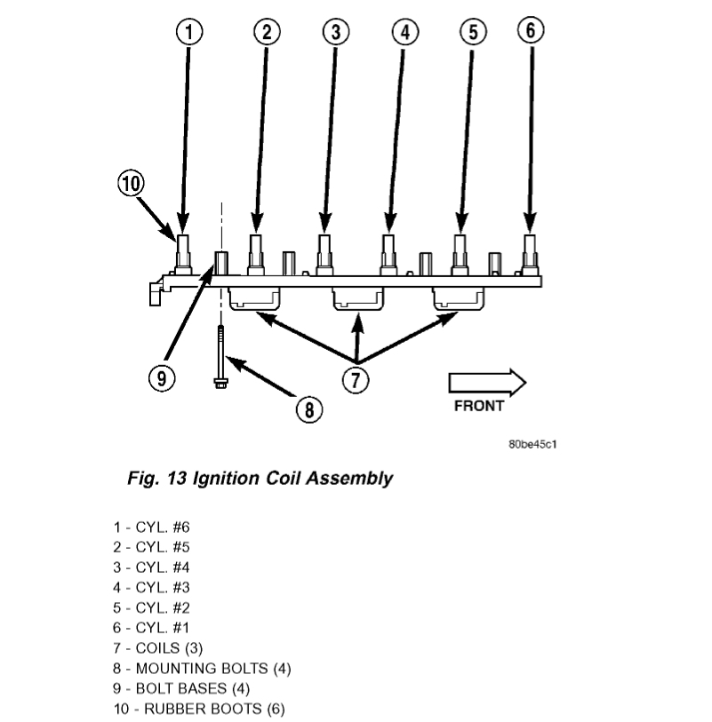

The engine will shut off shortly after cranking up and sometimes it takes longer but when I can keep it running it spits and sputters then shuts off, I can't keep it running long before it shuts off, I think about 20 minutes is the longest before it shuts off but fires back up. I installed a new crank shaft sensor, new plugs, all new gasket, rebuilt the throttle body, new fuel tank, along with line and filter and fuel pump new radiator and thermostat. here's the codes it's reading p0320, p0353, p0352, p0351, p139, p1495, now it was giving that code before it messed up, but I think that's because the smog control is not hooked up. I do all my own mechanic work, but I'm not a mechanic. Help

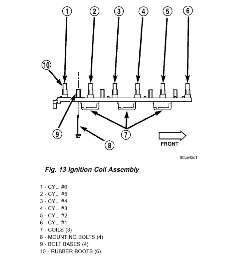

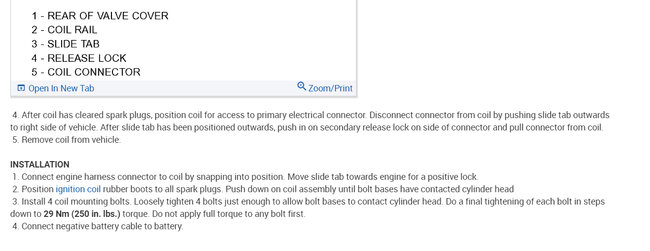

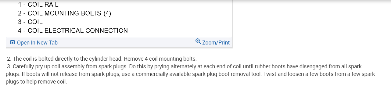

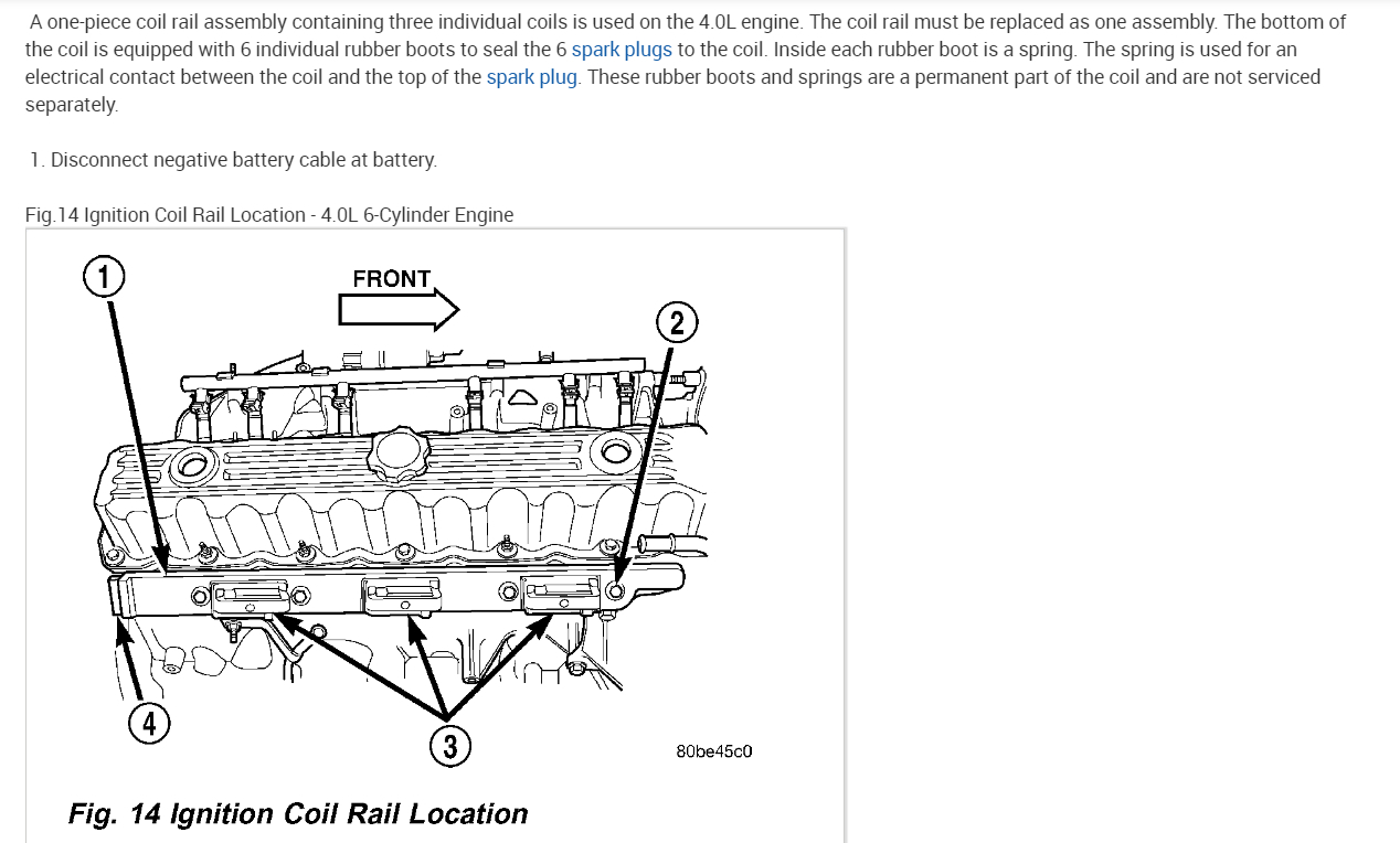

These codes are pointing to the ignition coil being bad.
P0320 Ignition/Distributor Engine Speed Input Circuit Malfunction
P0353 Ignition Coil C Primary/Secondary Circuit Malfunction
P0352 Ignition Coil B Primary/Secondary Circuit Malfunction
P1391 Powertrain Control Module (PCM) monitors the Camshaft Position Sensor (CMP) Or Crankshaft Position Sensor
P1495 problem in the vehicle's leak detection pump
Here are the instructions on how to change the coil out in the diagrams below. Please let us know if you need anything else to get the problem fixed.
