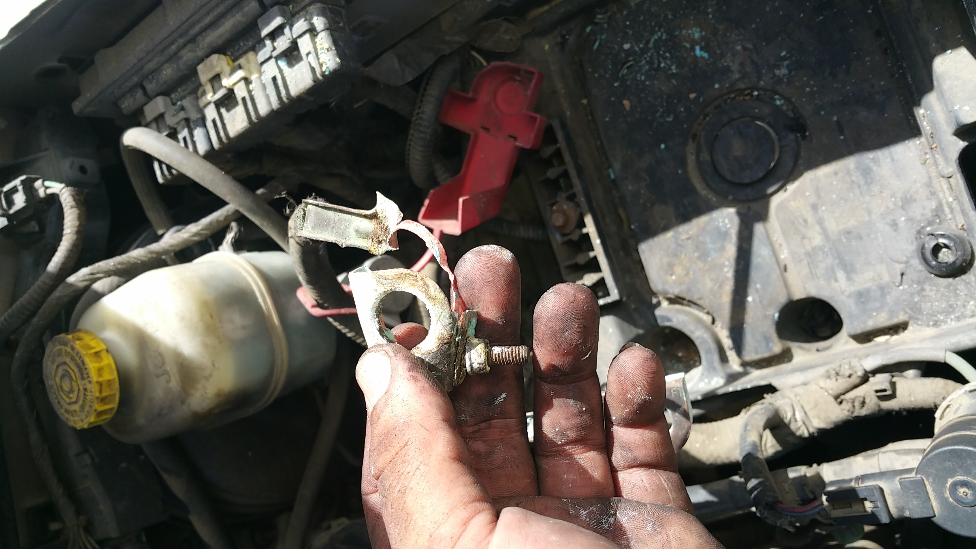

My vehicle keeps stalling when descending off a hill. I thought it was the fuel pump seeing that the regulator is attached inside the pump. I replaced the fuel pump yesterday but it still stalls when descending of a hill. I would restart the vehicle it does that no problem, but while driving on the flat coming to a stop or slowing down the vehicle would stall out. Any reason why? Need some help! I have not touched the fuel rail or checked the pressure. I am about to try some injector fluid see how that works.

Hi, firstly thank you for your reply. I bought a replacement pump that went inside the gas tank, the top piece that connects all. The hoses etc., I reused (not sure if that is the strainer ), I also changed the filter on the tank. About the battery running dead I have had a voltmeter in the Jeep for a few months now it has always read 12 volts an up, but yesterday I disconnected the battery to see if any wires at the bottom maybe touching. I also cleaned the throttle body and sensors, while putting the battery back on the terminal just fell apart in my hand (see picture). My hope is that the terminal was not giving enough power, when I go over speed bumps so how it knocks the terminal loose? I am going the change the terminal and also do that relearn technique for the computer you provided? I will post my results.

Alright, so today I reconnected terminals for the battery and had a lady look in n net the jeep for any wires touching. I have a s scan tool nothing fancy, it was always saying I needed to change my speed sensor. But day before scan t tool read another code related to the speed sensor but something to do a with it grounding this time. Upon looking we found out that the jack for the speed sensor was stripped. And rubbing against the e brake cable. Disconnected the jack took I it for a run, it ran fine nothing lower that 500 rpm and on start up it give about 1,000 rpm, which it as been doing since I got it. I am hoping the problem was the cables rubbing against each other. One thing I noticed was that my 12 volt outlet no longer works, but once the Jeep is running I am good.

Okay, so I looked at the sensor wiring and the wires were stripped from the sensor jack, it was rubbing against the e brake cable. The jack itself we took off I am in the process of finding one off a liberty. Hopefully that fixes it. But the Jeep had not stalled since we check those wires.
