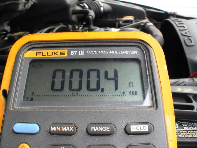

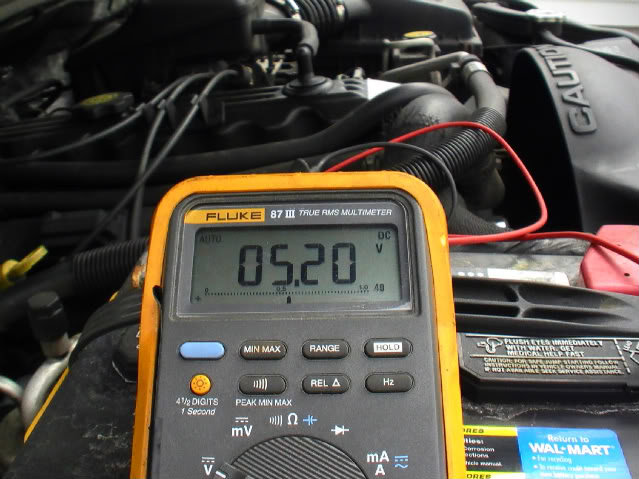

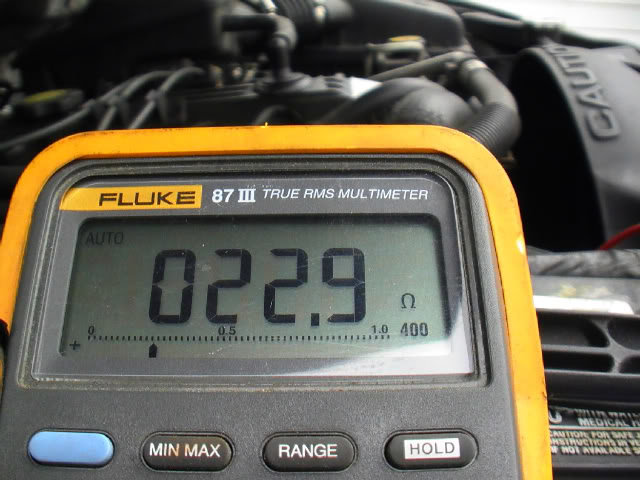

Checked the camshaft sensor. Here are the results.
https://www.2carpros.com/images/question_images/199241/original.jpg
Sensor voltage key on engine off
https://www.2carpros.com/images/question_images/199242/original.jpg
Ground Ohms ignition off key off
https://www.2carpros.com/images/question_images/199243/original.jpg
Key on engine off This video is the sensor signal wire with it running http://www.youtube.com/watch?v=wwAlcLdYdVQ In your last post you said if this is OK we are going to look at the knock sensor.......but i do not have one.
Mar 27, 2009 at 7:27 AM
RACEFAN966
  • 5,029 POSTS
Ok with all I can find what all you have already done it is leading back to the cam sensor. It should have steady readings not fluctuating. I am aprehensive about replacing it as you have spent lots of money already but nothing else makes sense with all that has been done and what the tests say at this point. Let me know how it goes.
