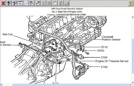

Recently I have noticed my oil pressure guage is pegge d all the way to high. After continuous driving of a few hours the guage will drop back to about the 75-80 % range. Is trouble in the near future. I am on a trip of 400 miles from home. Need I worry?

Sounds like the oil pressure switch is acting up-to confirm it check the oil pressure-if normal replace the switch
What model is this-Cherokee or Wrangler? So I can provide the pressure switch location

It is a Grand Cherokee

The oil pressure switch/sensor is located on right rear side of engine block -see below

Thank you for the info. Is it ok to drive the 400 miles to my home.I am "on the road"

Go for it and have a safe trip
