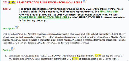

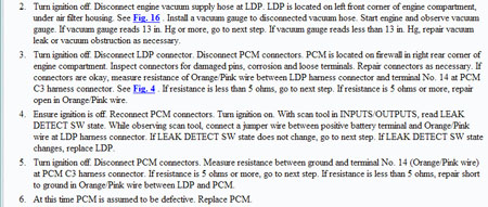

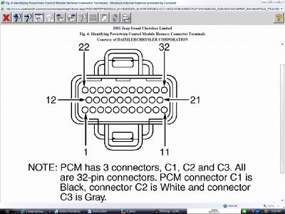

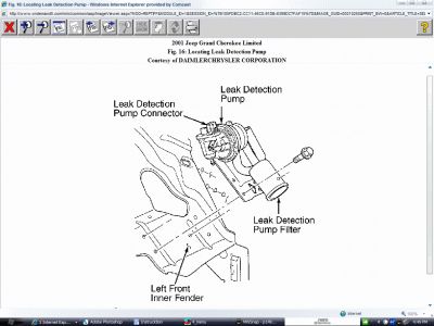

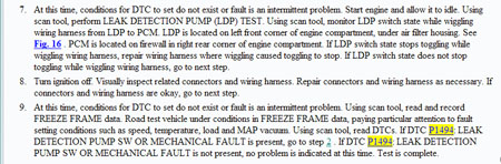

I have a 2001 Jeep Grand Cherokee and my engine light is on. I would like to know what (P1494 manufacture control auxilary emission control) means, and what i need to do to fix this problem. Thanks.

Here it goes...
