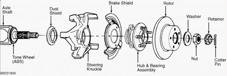

how do i remove the rotor and hub assembly on a grand cherokee laredo?

Raise and support vehicle. Remove front wheels. Remove caliper. See FRONT BRAKE CALIPER & BRAKE PADS . Attach caliper to underbody with wire. Mark rotor and hub for reassembly reference. Remove push nuts securing rotor to hub. Remove rotor from hub. To install, align reference marks and reverse removal procedure.
https://images.2carpros.com/forum/automotive_pictures/62217_Rotor_Front_1.jpg
To remove the rotor, DO NOT remove the cotter pin and large nut! Only remove that if you are removing the hub too.

thanks for the help so far, can you tell me how to remove the rear rotor and assembly too?

Same way! Front or back once caliper and caliper mount is removed they slip off, some mounts dont need to be removed, only if the outer part covers the rotor.
