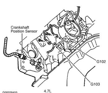

Where is the crank shaft sensor located on my 1999 Jeep grand cherokee? thanks

On right side of engine block,above starter motor.
https://images.2carpros.com/forum/automotive_pictures/12900_cp_1.jpg

I just did this a few moment ago. It is located behind the starter.Look just behind the transmission on the passenger side. It is hidden quite well as I found out, but once you remove the starter, you will see it very clearly. What problems are you having with you vehicle?
