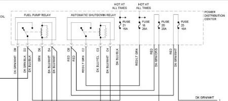

The car runs but then shutsdown.The engine lost voltage in the primary cicuit that supplys the coil and injectors then in afew minutes it returns. I replaced the computer on the car and it worked perfectly for 15 days then it started shuting down again,

Welcome, that primary voltage comes from the asd relay. Are there any trouble codes? Also, if the computer doesn't see the proper cam or crank signal, it may not ground the asd relay. I'd have to check circuits at the asd relay, without a code or something giving me a direction.

hello, I checked with the scanner and the codes read p0351, 1389, 1388

The first code is ignition coil, the next two, are for the asd relay. Check the asd relay circuits, voltage for the load side of relay is hot all the time. Voltage for control side of relay goes hot when you turn on the key. The computer grounds the coil side of relay in order to energize. If no ground, I always check the cam and crank sensor.

do you have a diagram of the electrical wiring

98 jeep cherokee, 4.0 litre engine. Asd relay
https://images.2carpros.com/forum/automotive_pictures/170934_asd_relay_98_jeep_cherokee_40_1.jpg
