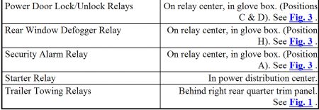

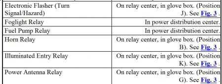

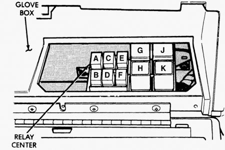

The keyless entry module is in the dome light, the relay center is in the glove box, here's the layout of that.
https://images.2carpros.com/forum/automotive_pictures/62217_1_60.jpg
https://images.2carpros.com/forum/automotive_pictures/62217_2_49.jpg
https://images.2carpros.com/forum/automotive_pictures/62217_3_40.jpg
It seems maybe a ground wire is not properly grounded?

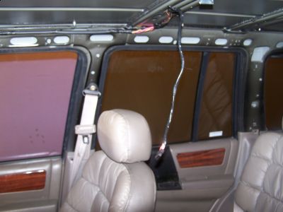

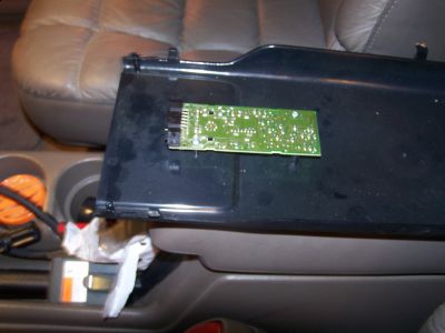

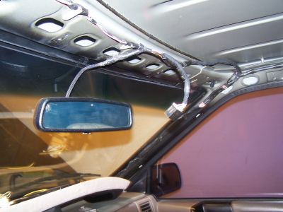

Thanks! That makes sense that the lights would be having difficulty working if there is a short in that somewhere... But the part that perplexes me is that if that relay is for the illuminated entry lights, why are there no light wires running from the actual overhead console lights to that particular switch... I completely took apart the overhead console and took off the old electrical tape and put on new tape. The little circuit board that it plugs into looks fine. I would test it but don't know how... Here's some pics of the wiring... Do you think it could have blown the little circuit board?
https://images.2carpros.com/forum/automotive_pictures/111752_100_3337_1.jpg
https://images.2carpros.com/forum/automotive_pictures/111752_100_3339_1.jpg
https://images.2carpros.com/forum/automotive_pictures/111752_100_3341_1.jpg
Jan 31, 2010 at 11:14 AM
MERLIN2021
  • 17,250 POSTS
Have a close look at the board with a good magnifier, you may find a crack in it, and might be able to resolder the joint/lines back together. Us a piece of wire to bridge any cracks instead of globbing solder on it!Pay particular attention to the plug/prong area.
