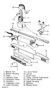

how do you change out a heater blower
Wednesday, January 28th, 2009 AT 10:54 PM
BMRFIXIT
  • 19,053 POSTS
Jeep what ???
BLOWER MOTOR
Removal & Installation (Cherokee - 2.5L Engine)
Disconnect blower motor connector in engine compartment, near blower motor. Remove blower motor screws. Remove blower motor.
To install, reverse removal procedure.
Removal & Installation (Cherokee - 4.0L Engine)
1.Remove coolant bottle retaining strap. Move bottle aside. Remove coolant bottle bracket. Remove anti-lock brake pump and bracket as an assembly (if equipped). Move assembly aside.
2.Disconnect blower motor connector in engine compartment, near blower motor. Remove blower motor screws. Remove blower motor.
Removal & Installation (Wrangler)
Remove heater housing. Remove blower motor screws and blower motor.
https://www.2carpros.com/forum/automotive_pictures/99387_Graphic1_176.jpg
