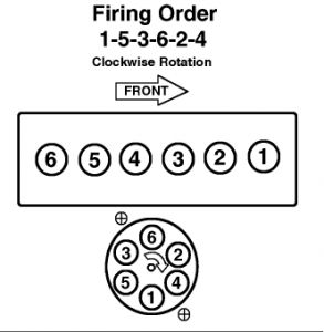

whats the firing order for a jeep 1990 pioneer 6 and rotation of distributor

Firing order
