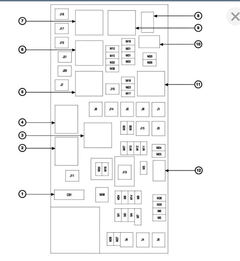

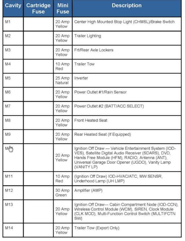

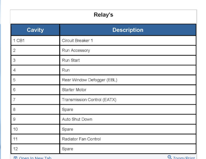

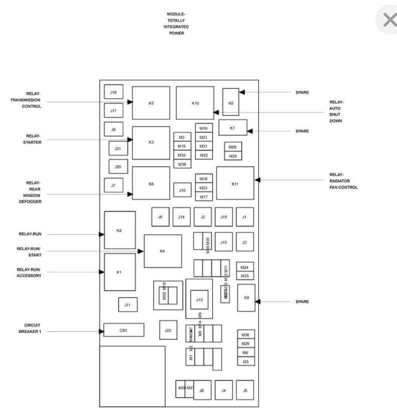

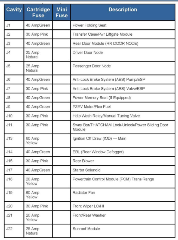

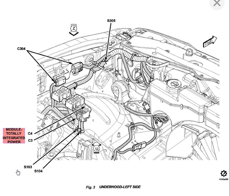

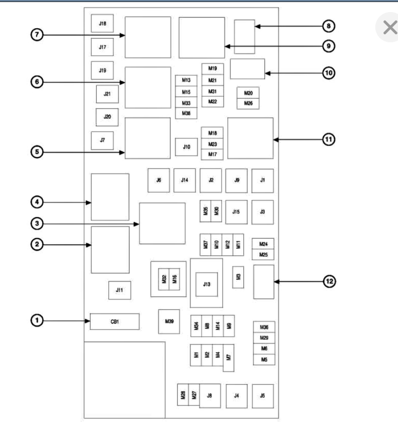

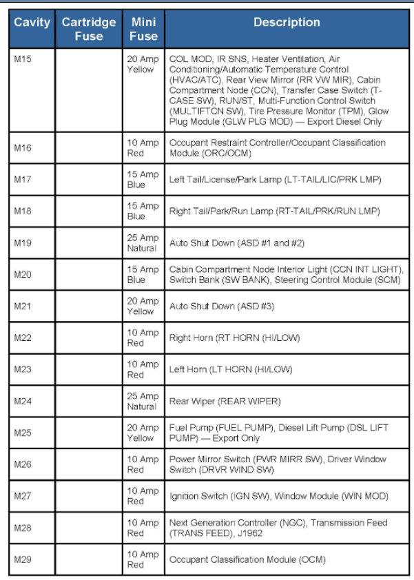

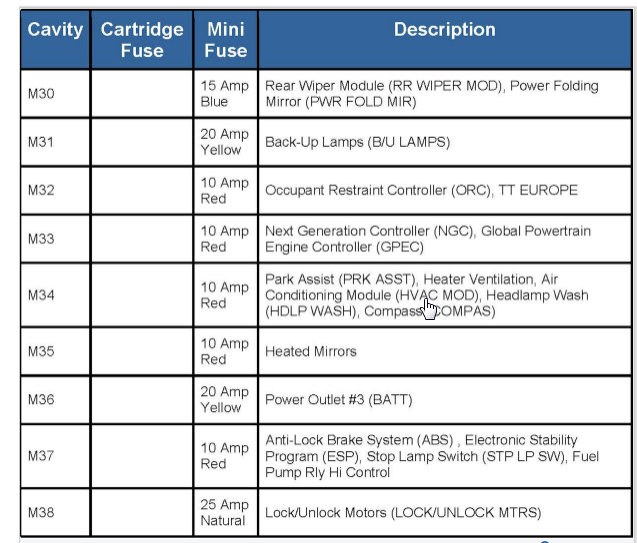

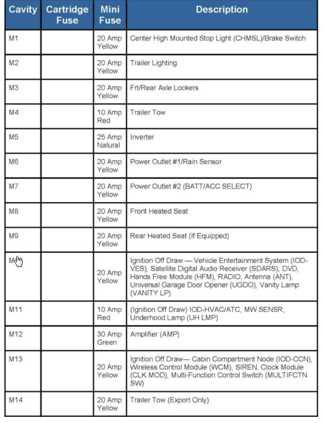

I am attaching the info below from the manual but here is a guide that will help with this as well:
Below is the info from the manual on where the fuses are and what they do.
