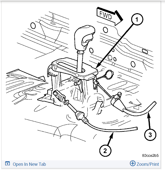

my ignition keys wont come out from my jeep liberty?
2006 JEEP LIBERTY
ZULEYMA69
Dec 13, 2007 at 7:04 PM
SERVICE WRITER
  • 9,123 POSTS
Call the dealer, your under warranty.
Dec 23, 2007 at 9:36 PM
  • 54,840 POSTS

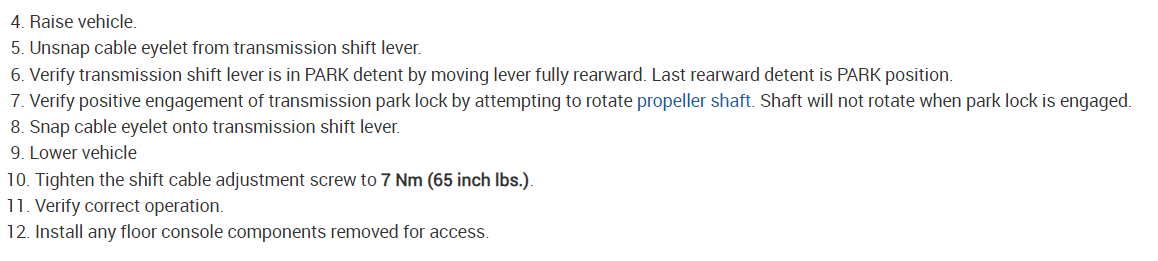

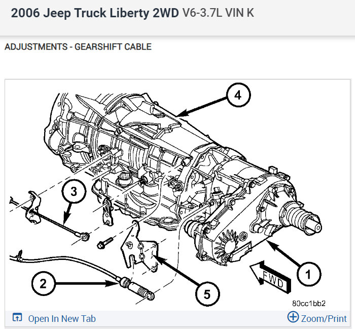

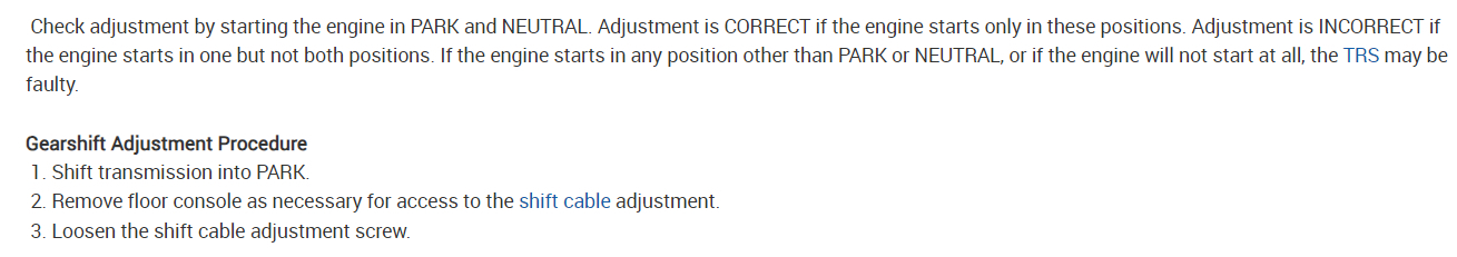

This happens when the shifter is not adjusted correctly which makes the key think the car is still in gear. Here is how to adjust the shift cable to help fix the problem. Check out the images (below). Let us know if you need anything else.
