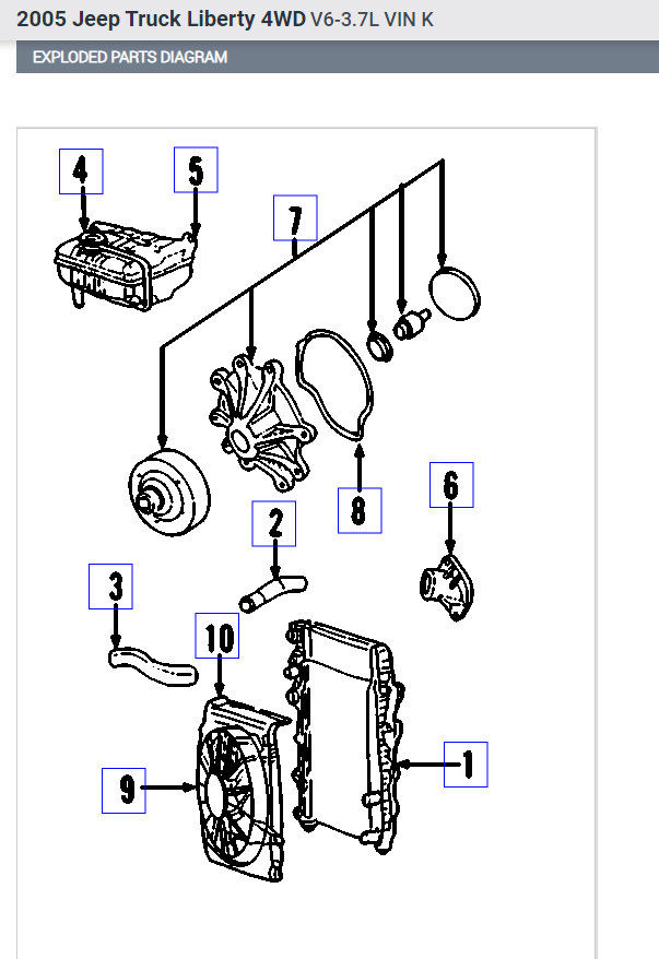

It could due to a stuck thermostat (as you have already replaced), It can also be due to a bad water pump or a clog in the cooling system. Another possibility is a inoperative cooling fan.
https://www.2carpros.com/articles/engine-cooling-system
A failed water pump can unable to to circulate the coolant through the engine, which will lead to overheating.
https://www.2carpros.com/articles/symptoms-of-a-bad-water-pump
If the cooling fan does not operate as it is designed to, it can lead to the engine running hot. An inoperative cooling fan can be due to a bad relay or wiring, coolant temperature sensor or the fan motor. Check to see if your fan comes on when the engine is at operating temperature.

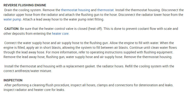

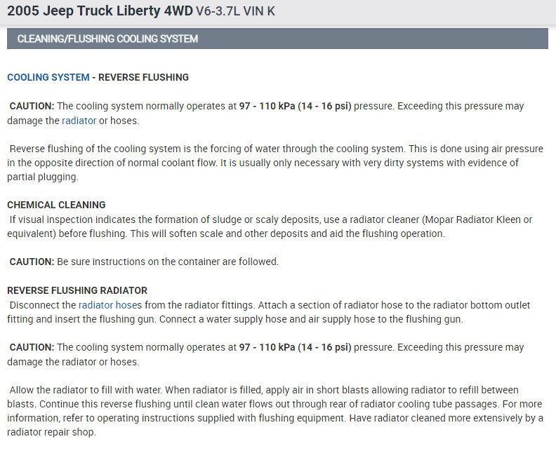

If there is a clog or restriction in the coolant system it will also over heat the engine. Try doing a coolant flush. Many times flushing the cooling system improves the engine cooling characteristics.
