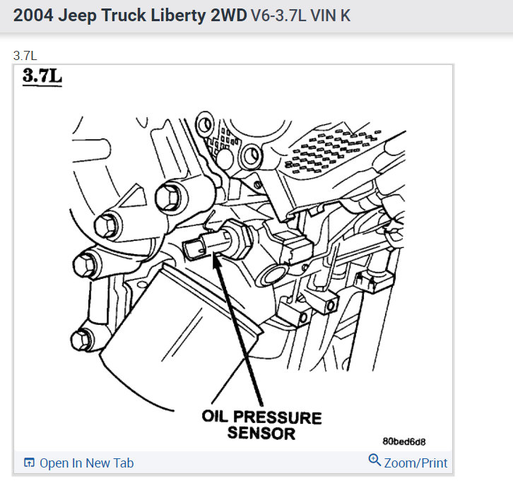

the oil light comes on intermittently and not sure why.it is full of oil and i always use synthetic oil.do you think it's a sensor?

the oil pressure sensor is down by the oil filter. Check out the diagrams (below). Please let us know if you need anything else to get the problem fixed.

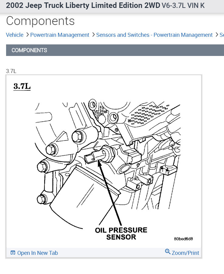

Where is the oil pressure sensor located on a 2002 Jeep Liberty 3.7L? What is involved with replacing it?

Its on lower left front of engine above oil filter-unplug it then remove the sensor. Check out the diagrams (Below). Please let us know if you need anything else to get the problem fixed.
