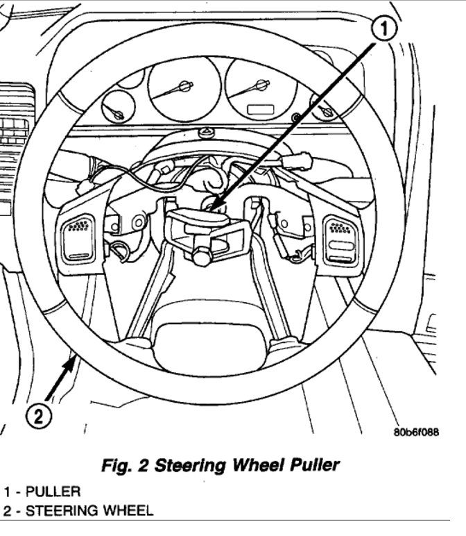

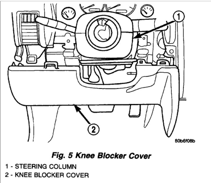

For a few months, the key will not turn in ignition occasionally, usually in cold weather. After repeated quick in and out thrusting with the key, it would eventually start. Now the key won't turn MOST of the time.
Mar 26, 2009 at 5:35 AM
  • 55,432 POSTS
Hello

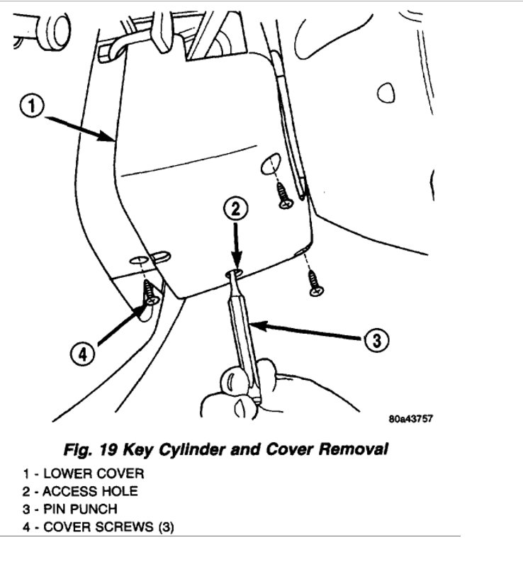

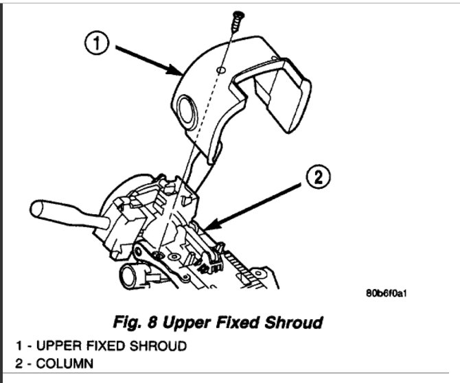

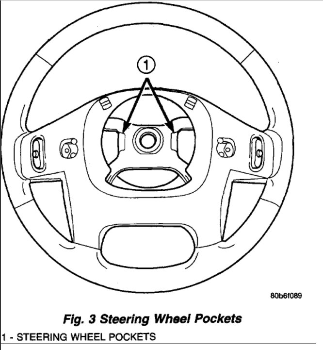

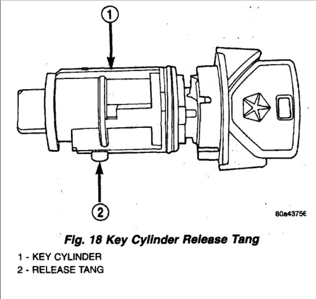

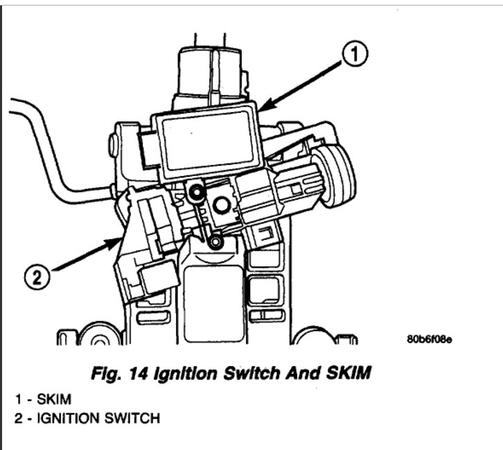

The cheapest solution to try here is to spray WD40 or equivalent light oil into the ignition lock cylinder and work the oil in very well with your key. If this does not help, there are other very common reasons why this issue is happening. You can find this information at our Car Repair Troubleshooting page. Just follow the link below...
https://www.2carpros.com/first_things/why_wont_my_ignition_switch_turn.htm

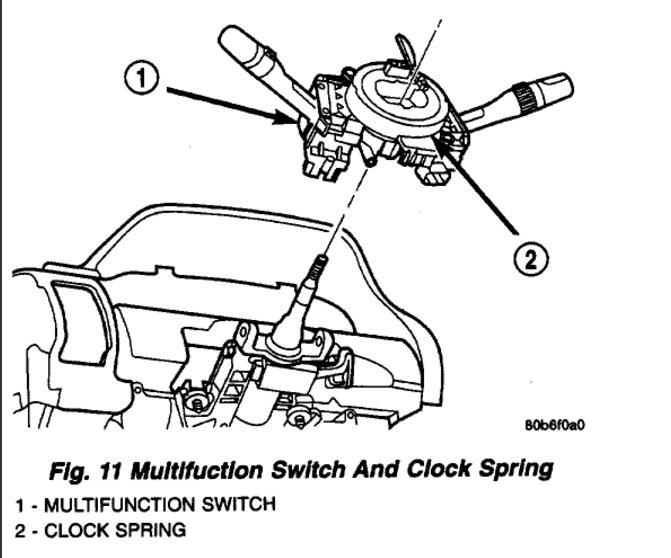

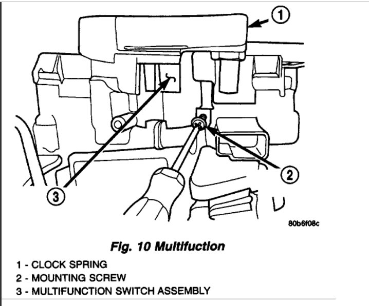

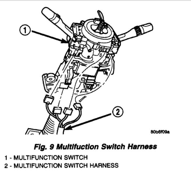

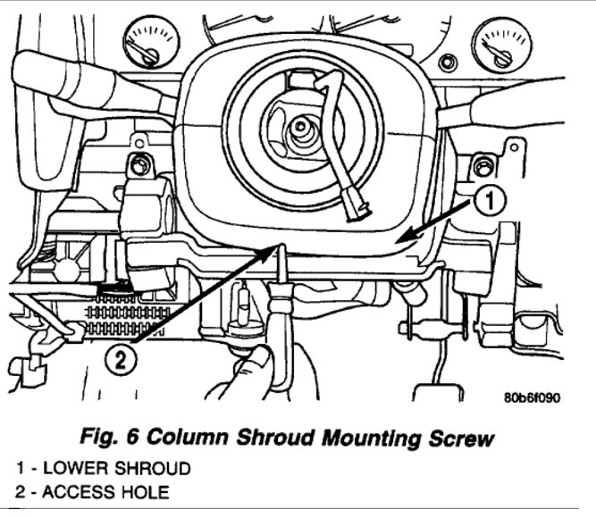

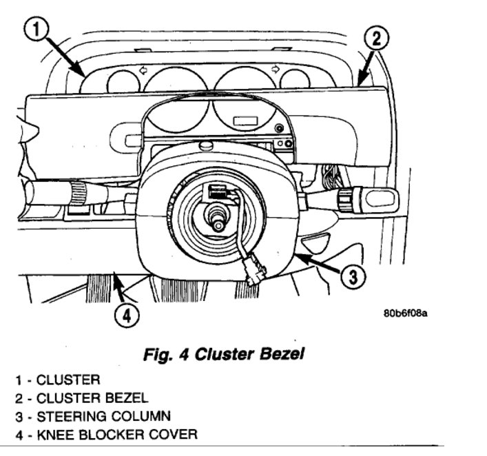

If that does not work you will need to replace the tumbler which is common here are the diagrams Below to get the job done.
If you need further assistance just let me know.
Mar 26, 2009 at 7:25 AM
DEBWISE
Yep had to replace the key tumbler thanks for the diagrams really helped me. I love this site BTW
