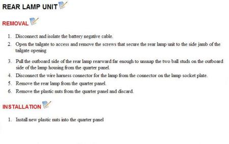

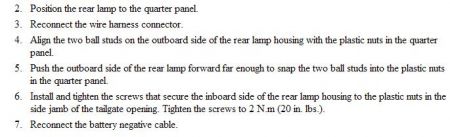

how do i access the brake light bulbs
Sep 25, 2009 at 12:30 PM
BLUELIGHTNIN6
  • 16,542 POSTS
Remove the rear lamp units as follows to access and replace the brake lamp bulbs...
