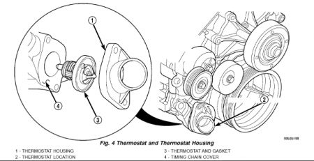

2002 Jeep Liberty 6 cyl Four Wheel Drive Automatic
where is the thermostat located
Oct 14, 2010 at 5:58 AM
BMRFIXIT
  • 19,053 POSTS
If thermostat is being replaced, be sure that replacement is specified thermostat for vehicle model and engine type. Disconnect negative battery cable at battery. Drain cooling system. Raise vehicle on hoist. Remove splash shield. Remove lower radiator hose clamp and lower radiator hose at thermostat housing. Remove thermostat housing mounting bolts, thermostat housing and thermostat
https://images.2carpros.com/forum/automotive_pictures/99387_1_20.jpg
https://images.2carpros.com/forum/automotive_pictures/99387_2_11.jpg
Oct 14, 2010 at 6:05 AM
  • 75,992 POSTS
https://images.2carpros.com/forum/automotive_pictures/12900_stat_8.jpg
