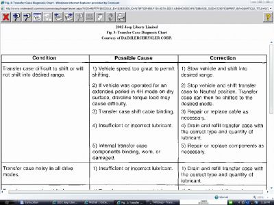

I used my 4 wheel drive then when I was done I put my manual hand stick back down into 2hi.but my parttime light stays on it feels like i am in 2wheel but some time it grips when i tuurn on a tight corner at a low speed and my gas mileage has changed.

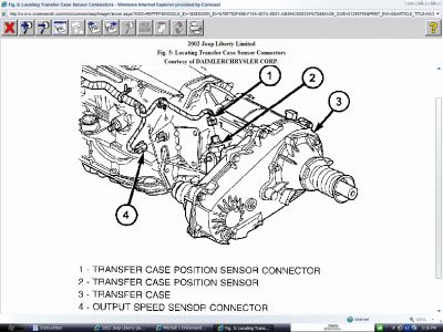

If no fuses are marked, and I'm with you on that...manual I have does not show any, try unplugging the actuator at the front axle, see if it goes into 2 wheel drive, then plug it back in to see what happens...
Dec 22, 2007 at 12:07 PM
JDKELLY15
i am brain dead i cannot find the acuator plug where is it located.there is a line plugged into the transfer case is that it

Here's what I came up with, these are the connections and troubleshooting chart.
https://images.2carpros.com/forum/automotive_pictures/62217_Trans_Case_1.jpg
https://images.2carpros.com/forum/automotive_pictures/62217_Trans_CaseChart_1.jpg

Too bad you can't scroll down on the trouble shooting chart!
Feb 19, 2011 at 11:30 AM
MERLIN2021
  • 17,250 POSTS
I chose the section that best answers the description.
Post your email and I'll send what I have.
