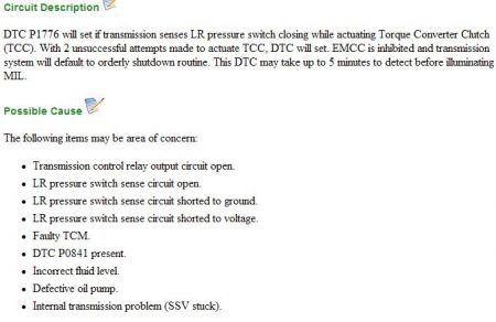

I get error p1776 off and on.
Solenoid Switch Valve latched in left rear position.
Can you help me figure out what to look for? I'd like to at least have an idea of what I'm dealing with before I take it in for repairs if it's not something I can do myself.

Hello Thanks for the donation. Below is information that you can relay back to your mechanic so that he/she can diagnosis your issue much quicker.
https://images.2carpros.com/forum/automotive_pictures/261618_Noname_74.jpg
Hope this helps.. Thanks for using 2carpros.com!
